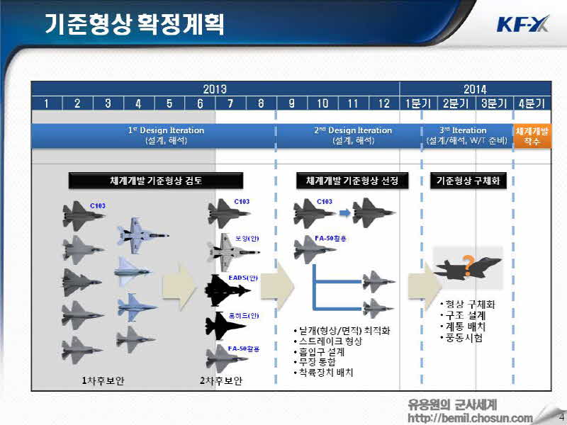

This is one of the presentation slides from the time, in 2014.
As you can see, up until 2013, there were different options being considered for KF-X development. One of which is the F-16 based model from LM. These options were also connected to the F-X program, in which Boeing, LM and EADS competed with Super Hornet, F-35 and F-15SE/Advanced Eagle respectively. The winner was required to participate in KF-X program as an offset, either as technology assistance provider or as a developmental partner which would provide a base model for a KF-X derivative fighter.
LM's proposal was projected to cost around $5.4 billion, as I've said. I've unfortunately forgotten what the EADS and Boeing proposals were projected to cost, but considering the fact that EADS and Boing at the time have made extravagant offers that they can't realistically fulfill, all due to their severly disadvataged position in the competition against LM's F-35, it was hard to believe their claims in face-value anyways.
Also, LM's proposal and its projected cost was also in-line with past examples, considering that it costed Japan around $3.3 billion to develop F-2 in corporation with GD/LM. Considering the inflation, $5.4 billion for a new F-16 derivative fighter seems fairly reasonable.

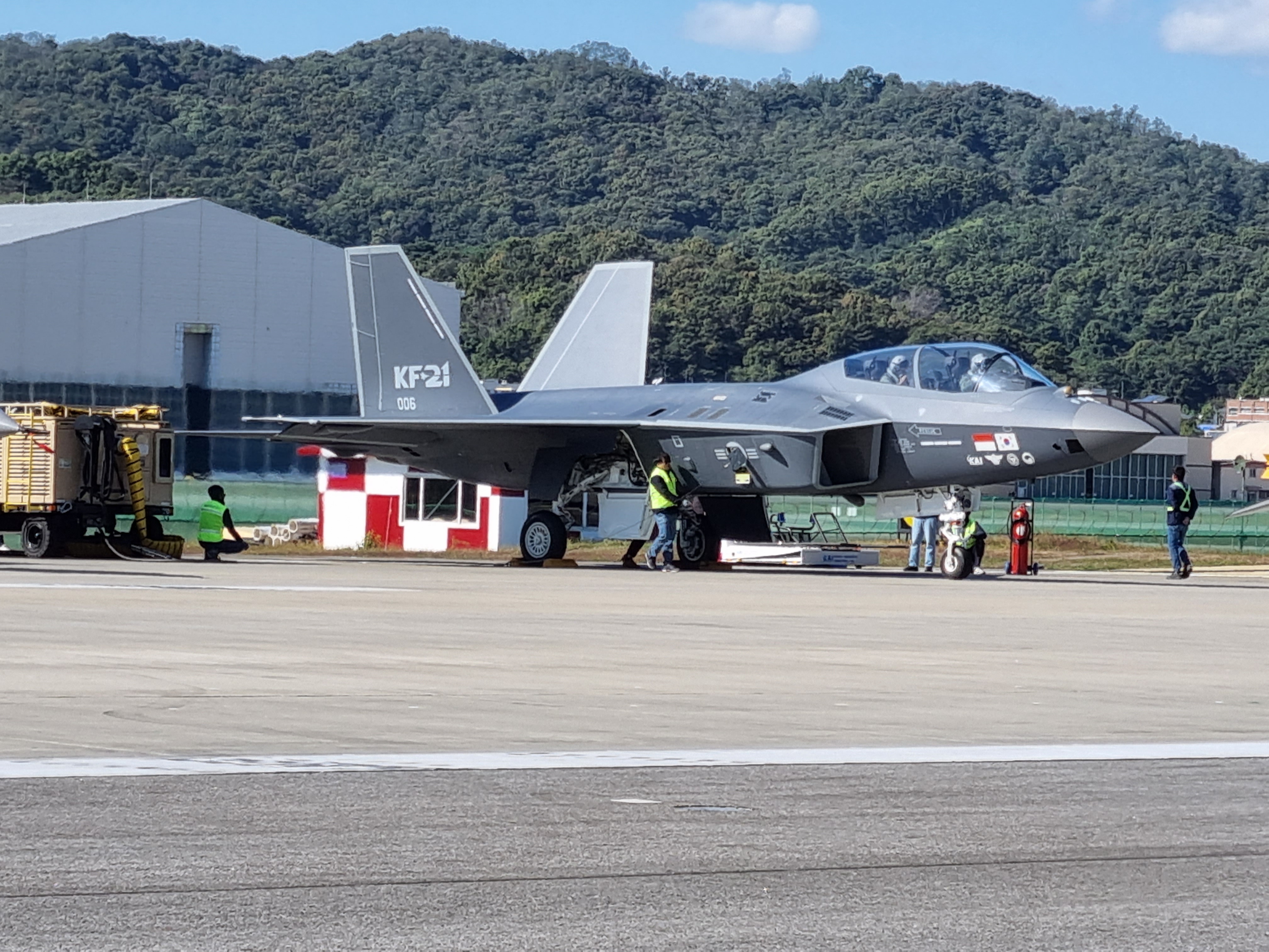

In an interview with KF-21 test pilot Jin Tae-beom at this ADEX 2023, you can see how far the development has progressed so far and what tests are scheduled in the future.
1. Due to ongoing development, the maneuvers from the demo flight are only halfway to the target performance. At the next ADEX 2025, we will demonstrate maneuvers that are as close to the target performance as possible. (Even though it has only been a year and three months, I could feel that it was purely "surprising" to show such a stable maneuver.)
2. It has been one year and three months since the first flight in July 2022. Over 330 test flights have been conducted so far. These were mainly in the areas of airspeed and safety, flutter tests and stability & control flight tests.
3. The KF-21 still has a long way to go as it needs to undergo more than 2,200 flight tests. The high angle of attack test is next on the agenda, which is preceded by an engine restart test in the air. (Testing will be handled by Prototype Unit 2.)
4. An aerial refueling test is scheduled for next year, 2024.
5. The performance of the AESA radar has been verified through some testing. Further tests are planned, and an air-to-air missile launch using it is expected in mid-2025.
