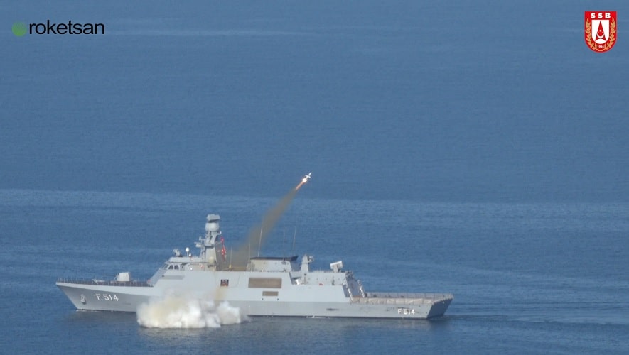

Atmaca is going to be a big game changer in the Aegean Sea.
It can go round an island and hit it’s target that is on the other side of the island. With it’s “super sea skimming” capability, Atmaca can stealthily approach a target hiding behind islands and destroy it ; Either by going round the target or suddenly rising and going over the island then dipping back again.
quote:
SavunmaSanayiST.com tarafından edinilen bilgiye göre; Türk Deniz Kuvvetleri’nin ihtiyaçları kapsamında geliştirilen ATMACA Gemisavar Füzesi, “Gelişmiş 3B Görev Planlama” özelliğine sahip. Bu özellik sayesinde ATMACA operatörü mürettebat, ATMACA’nın hedefine giderken izleyeceği rotayı önceden planlayabiliyor ve rota bacakları ekleyebiliyor. Hedef platformun Adalar Denizi’nde yer alan bir adanın arkasında bulunduğunu düşünürsek; fırlatılışından itibaren Super Sea Skimming özellikle seyir alan ATMACA, hedef platformun önünde yer alan adanın etrafından dolaşabilmekte veya ani bir şekilde yükselme-alçalma yaparak hedefi imha edebilmektedir.
Unquote.
I am looking forward to hearing about the sub launched version of this missile. Especially with the new gasket they are building that will help launch it about a km away from the sub, hence, preventing to give away sub’s position.
Unquote.
Is there any info on when the tests with KTJ3200 will start?
4,259
256 22,242
KTJ3200 acceptance tests had been completed earlier in June this year. It was in serial production phase. Last news was that a live sinking of a sea platform with ktj3200 powered missile launch was to be performed.
