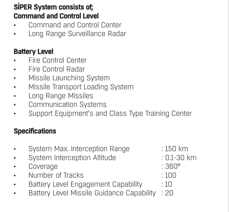

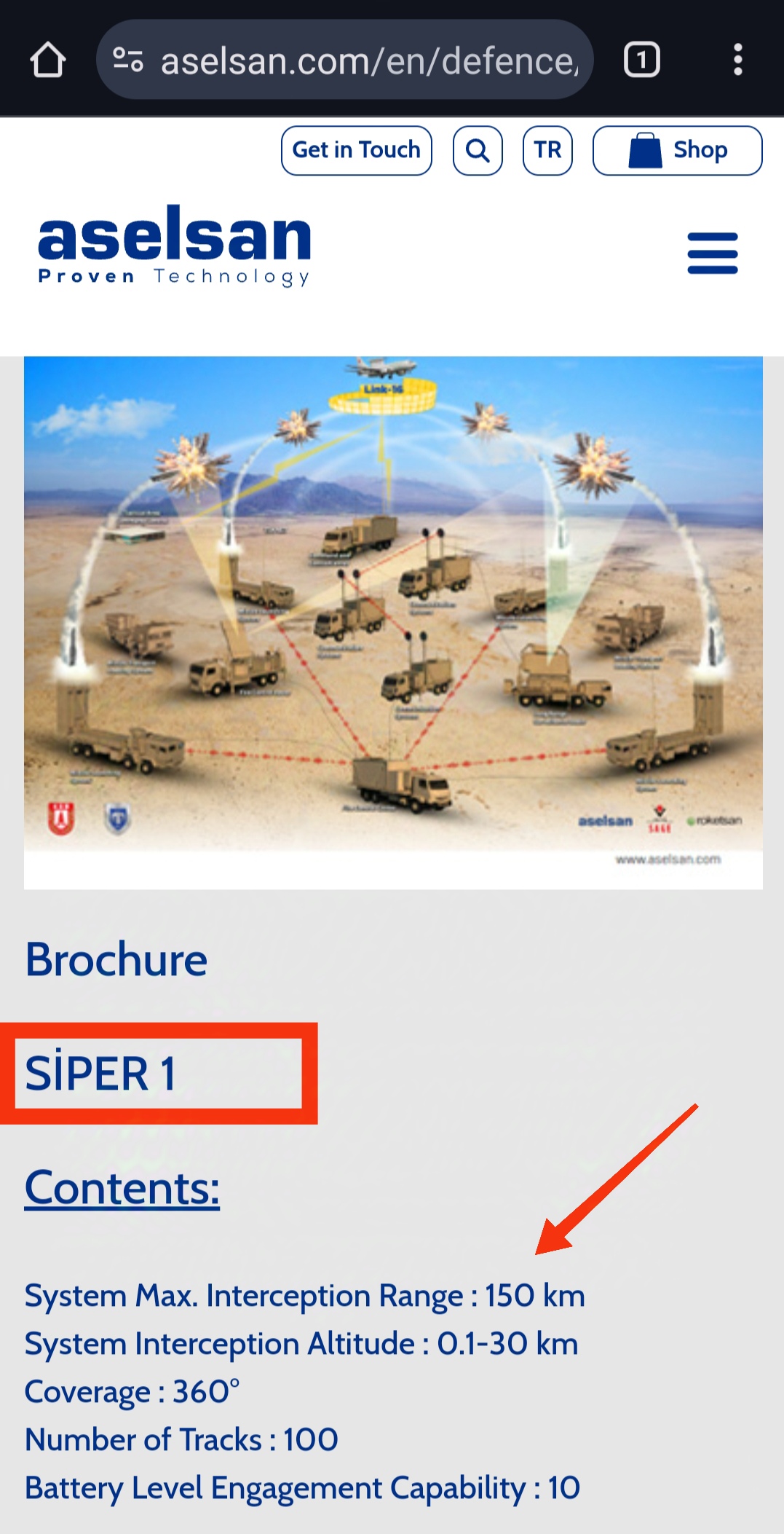

Look at the catalogue. Siper 1 Range with booster is 150km.
@Yasar_TR Dear the info in the catalogue is accurate?Does Siper1 have max range 150km?

Siper missiles are solid fuelled dual pulsed rocket engined missiles produced by Roketsan.
Roketsan has given 100km range for the Block-1 and 150km range for the block-2 missiles.
Aselsan is not the missile manufacturer per se. They are responsible for guidance and electronics and are coproducers with Roketsan of the Siper System with the help of Tubitak Sage. However if you read Aselsan’s document on Siper, it gives you an overall system maximum range of 150 km. That is correct as the system uses the same canister and hardware for Block-1 and Block-2 missiles.
Block-1 missile has a diameter that may allow it to be quadpackable.
Yet the Block-2 missile seems too wide for quadpackability. But could be dual packed.
