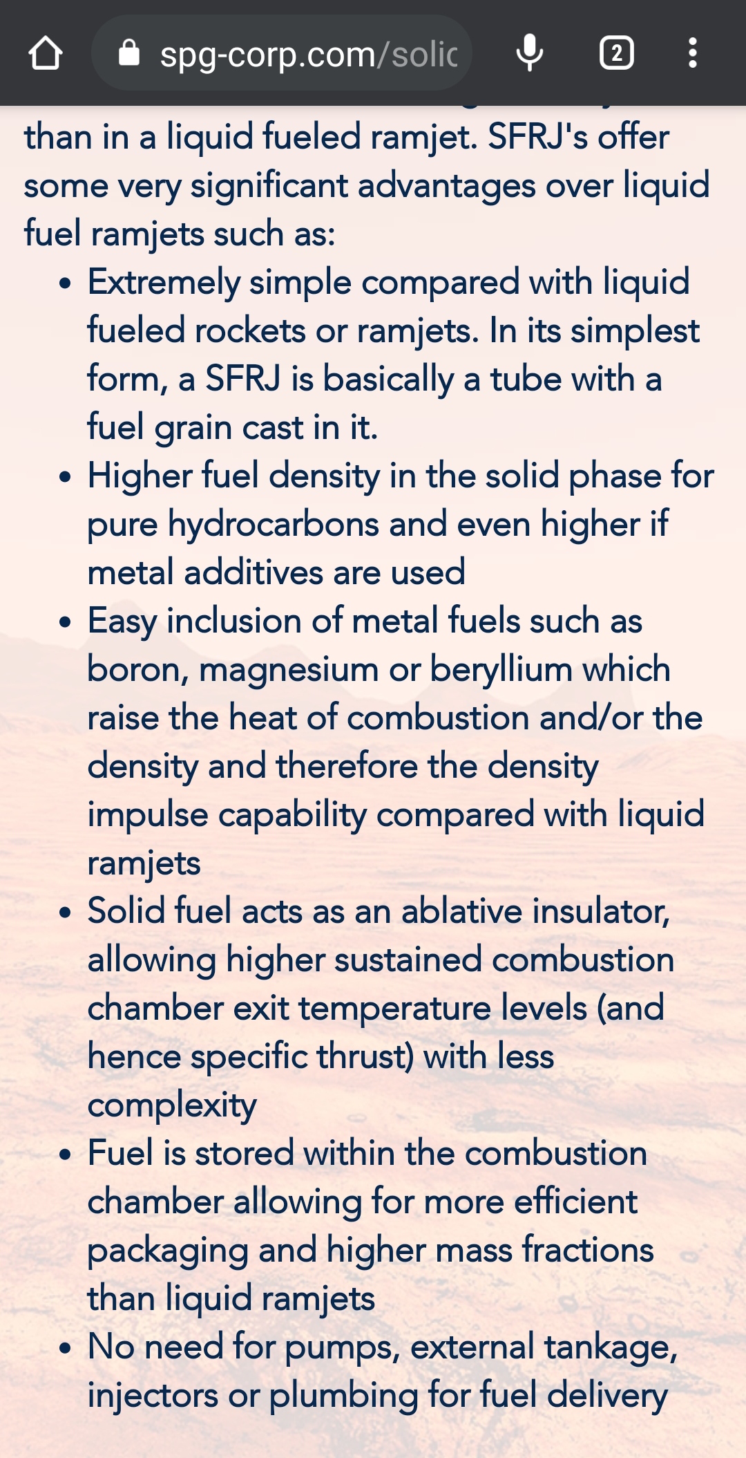

What fuel does ramjet use?
Look what Jews found
"THE PERFORMANCE OF A BORON-LOADED
GEL-FUEL RAMJET"
The prediction of the combustion temperature and products was performed us-ng the NASA Gordon and McBride code, CEA [9].
Two mixtures were examined. The first mixture served as a reference and consisted of a 100% Jet-A fuel
mixed with an organic gellant. The second mixture was composed by 60% Jet-A fuel mixed with the gellant and 40% boron.
