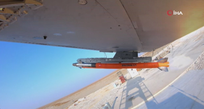

This is, if I am not mistaken, Bozdogan missile. Both Bozdogan and Gokdogan have solid fuel rocket engines. They burn all the fuel they have to bring the missiles to their 4 Mach top speed. Then at terminal stage they have no new thrust. Each time they have to make a sharp course correction, they lose some of their speed. They are actually travelling on the initial speed they have been given. So they may be sort of accepted as ”ballistic” even though they are not really moving under the effect of gravity. (We do call a revolver-bullet’s motion as ballistic as gravity plays a big part in it’s trajectory. In this case Bozdogan’s motion can be deemed ballistic)
But a throttle-able ramjet engine has thrust until it hits it’s target. So it can not be deemed to have a ballistic motion.

This is, if I am not mistaken, Bozdogan missile. Both Bozdogan and Gokdogan have solid fuel rocket engines. They burn all the fuel they have to bring the missiles to their 4 Mach top speed. Then at terminal stage they have no new thrust. Each time they have to make a sharp course correction, they lose some of their speed. They are actually travelling on the initial speed they have been given. So they are ”ballistic” .
But a throttle-able ramjet engine has thrust until it hits it’s target. So it can not be deemed to be ballistic.

Exactly! The rocket engines of these missiles only work for few seconds to bring them to their top speeds. Then they travel with their kinetic energy. As they are moving without thrust they are being effected by gravity. So can be deemed to have a “ballistic” trajectory.
But a throttle controlled Ramjet, has thrust till the last second.

In the context of weapons tests, "ballistic" just means the munition is tested without guidance.
