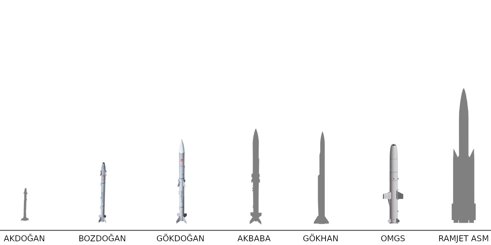

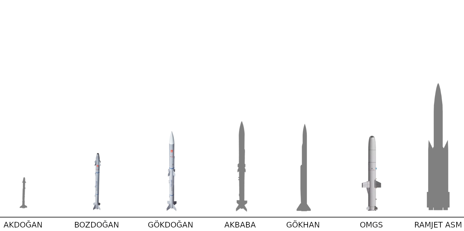

Sizing is completely wrong but still a illustration

I think it's the Gökhan ramjet missile we see in this image.
