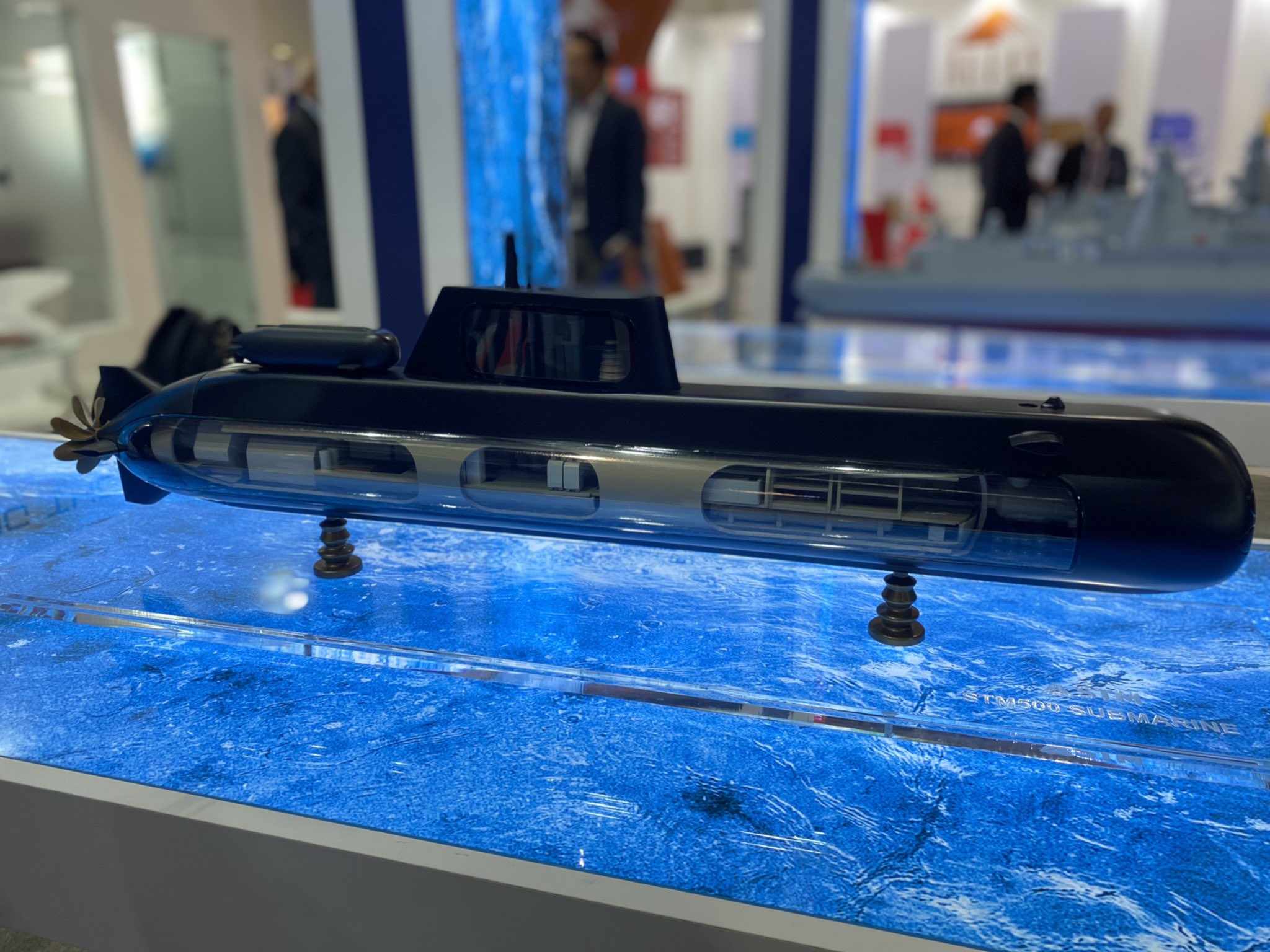

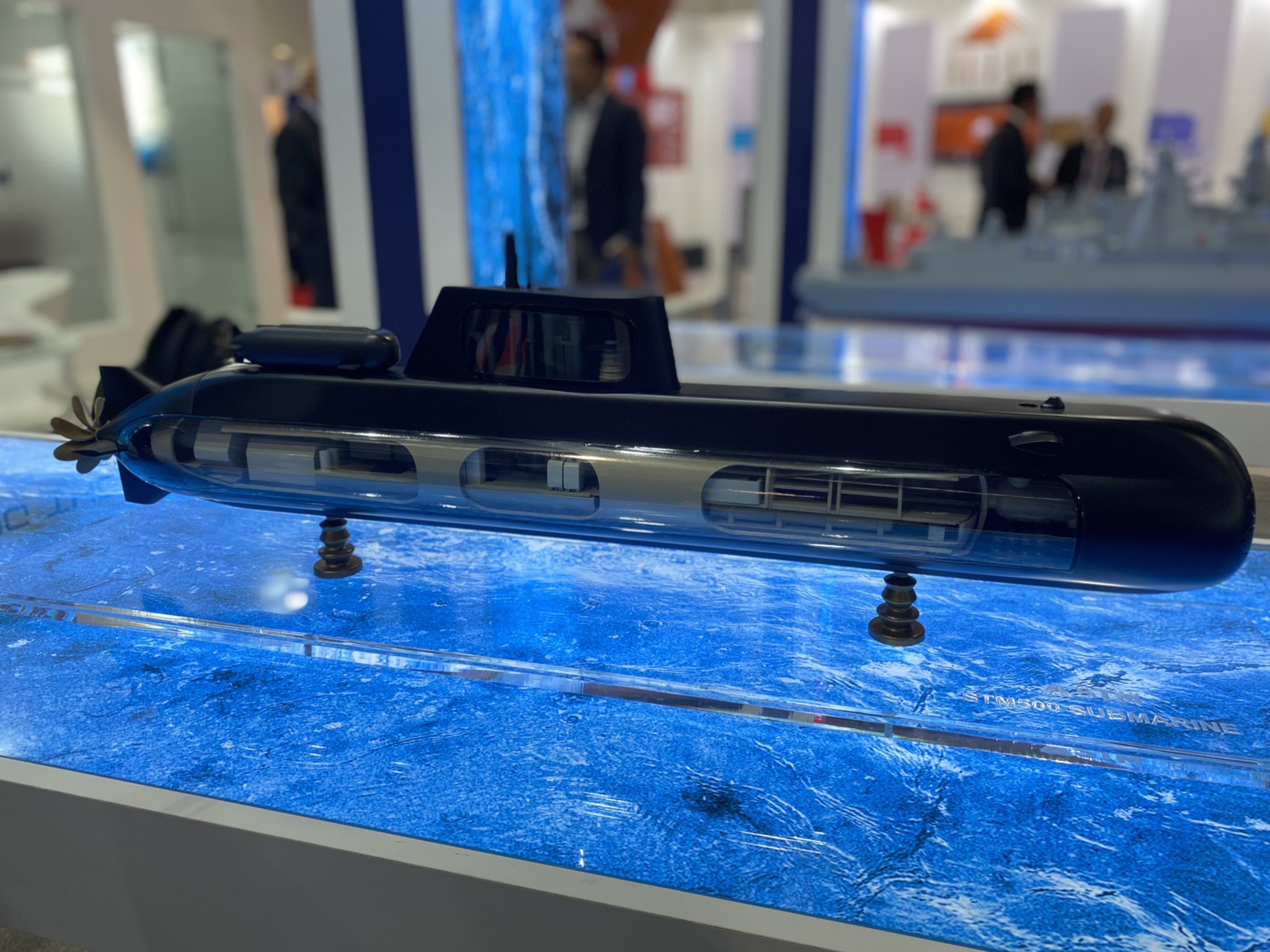

İsmail Demir: "We are developing a kamikaze unmanned submarine that can be used in submarines."
İsmail Demir's statement 2 years ago
This rather can be a loitering type of torpedo, running on an ideal speed with passive motion modes to track & hunt.
Possibly they will be using the common structure of SDV for that purpose too.
Then this question arises, UUV project has been around for a decade or so but why wasn't there any proper studies on underwater autonomous motion and related mission planning-decision making?
