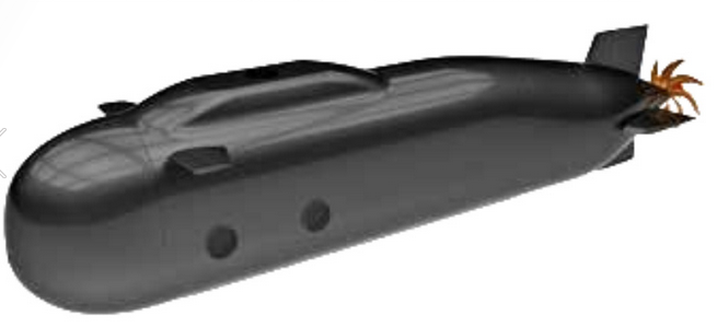

Datum AŞ multi-purpose midget submarine design, that will be the base configuration for 4 different designs (to start with); SOF Delivery (shown in image), Submarine Rescue (limited depth), Touristic submarine and modular submarine development test-bed, the project is now supported by SSB via TKY (Technological Contribution Responsibility) of the Sefine Shipyard - DIMDEG project.
The SOF variant will have a floating antenna.
Fits into a 20TEU container and transport aircraft.
Don't know if it counts since it is rather an R&D and technology gain project.
DATUM - ITU NOVA (SSB project)
  • Multi purpose midget submarine technology demonstrator (under construction)
Told y'all. It is under construction, In a few weeks the company is expected to hold an event to present the progress.
Primarily a test submarine, technology demonstator and base for future unmanned submarines as a working mini-sub platform. However, it requires decent amount of workmanship to transform into a military product, as is - it offers quite a good start. It is a great capability and know-how to be acquired by a start-up.
Double hull (FRP outer hull, steel inner hull), 2 foldable periscope configuration, 2 torpedoes (for tests), electric submarine, 4 crew (2 operator, 2 test team).

Awesome. So it will be built just As a test bed to test EW and other components for future mini sub projects. Is it correct?
5,249
101 23,493
Testing any underwater or submarine based components, and possibly anything would be related to unmanned submarines in far future.

According to photos, could you please elaborate specifications? Dimensions, weight, range, cost?
Fully electric without Diesel? And two heavy 533mm torpedos?
Length: 12 meters
width: 2,30 meters
diving depth: 300 meters
cruise speed: 4 knot
maximum speed: 8 knot
cruise time/endurance: 20 hours on 4kt
Crew: 4
main propulsion : Lead-acid battery
The maximum depth is really impressive. 300 meters.
2,452
31 4,298
Length: 12 meters
width: 2,30 meters
Crew: 4
Absolutely maximum depth is great.
İt might weight around 30-40 ton.
This is a TKY (Technological gain liability) project, likely a percentage of DIMDEG project is used for here. Shouldn't be more than few million dollars including the R&D.
It is transportable by a low-bed truck, so definitely not that much. The dimensions are overall, a portion of the dimension is floodable (between the two hulls). My bet would go for less than 20 or even 15 tons.

Another question how long would it take to recharge its battery at Naval base? 20 hours?
And another question: could it be launched from a simple launchpad at any random location (geography permitting) after being transported on a truck?
The advantage of such a mobility gain would be amazing
5,249
101 23,493
Not sure of the exact battery configuration but shouldn't exceed 3 hours.
This is the entire point of making it transportable.
So, a mobile launchpad will also be transported to to the designated launch point. Cool.

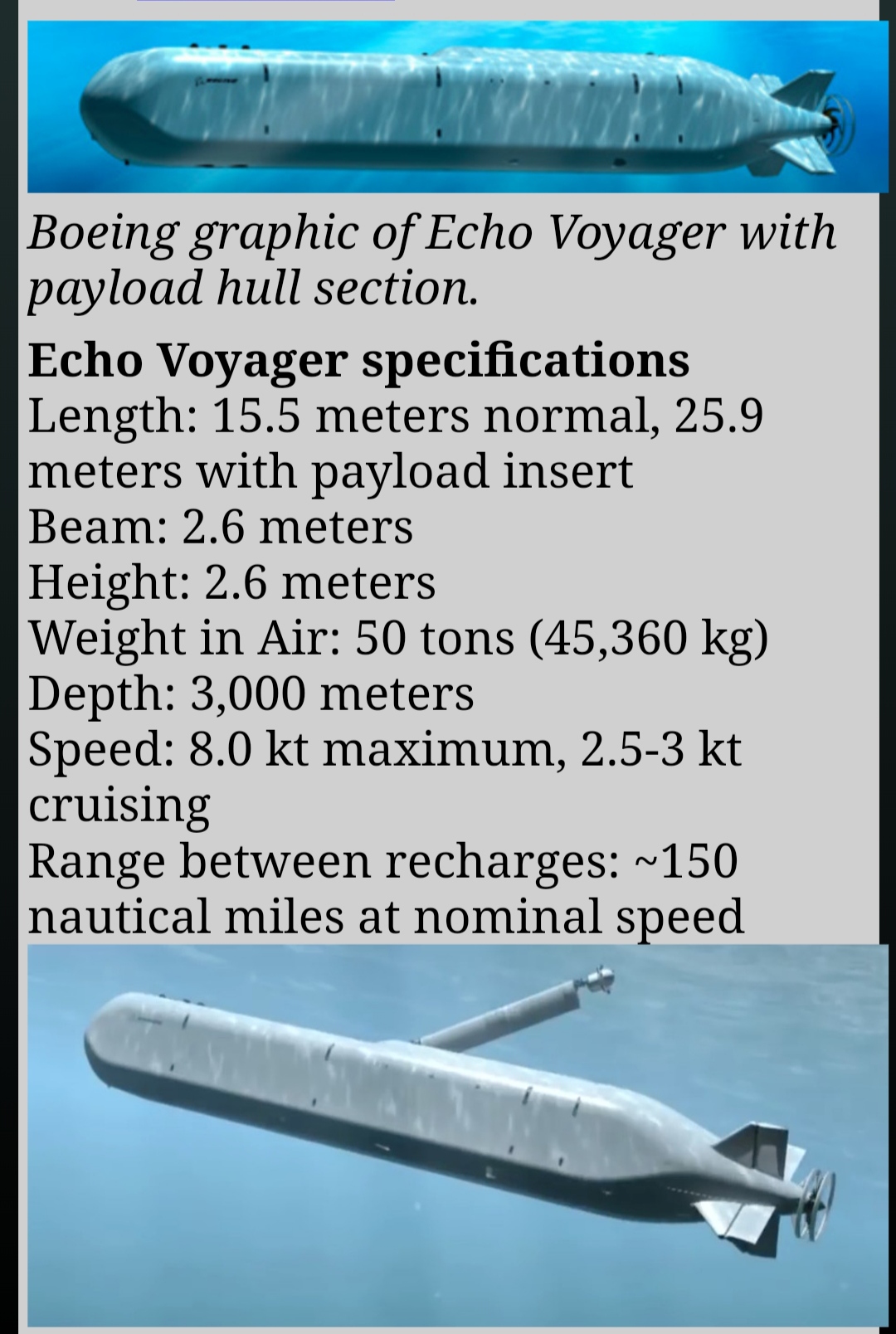

Our Navy knows its shit! We are competing with Americans.
That's a completely different class though, not just in its displacement, endurance and depth but also it has made multiple tests and a contract was already awarded for the actual unmanned submarine to be built based on this design. We are just taking first steps now.

Semi-autonomous mini submarine seems to me more effective rather than fully autonomous one .
İt doesn't require inefficient navigation system which limits missions while reducing crew saves more space, oxygen resources.
I wish modern MBTs to be one manned.
Two manned mini-sub like modern fighter aircraft.
Look at Boeing's Navigation system:
"The XLUUV’s navigation system features a proven Kalman filtered Inertial Navigation Unit supported by Doppler Velocity Logs and depth sensors offering superior directional accuracy"
