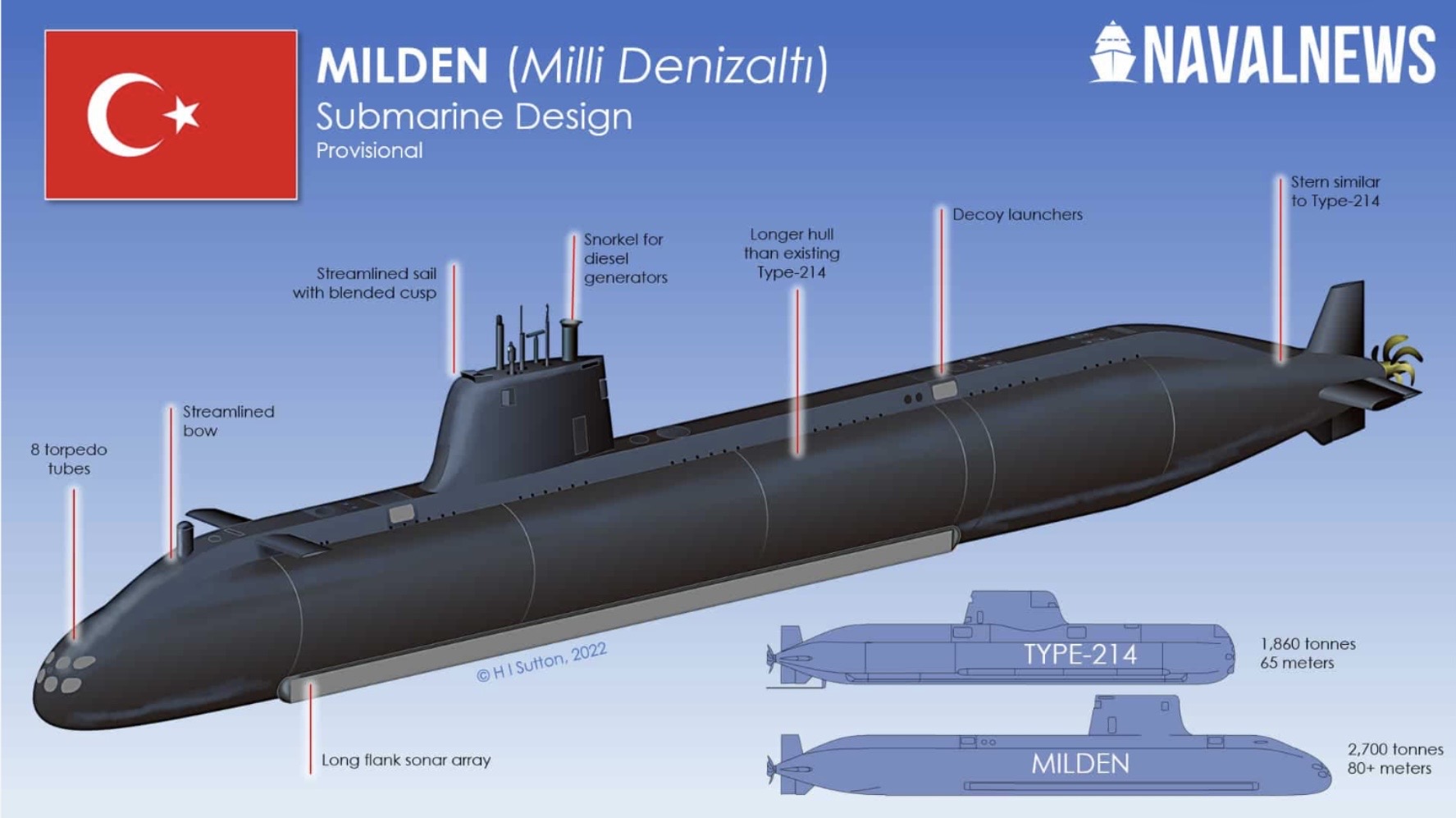

MILDEN, the national submarine program, is still at the early stage. If a submarine is going to screen the task force early on it is most likely going to be a Reis-class boat pulled in for forward patrol duty, not a MILDEN unit, since that build timeline realistically runs past 2030.
