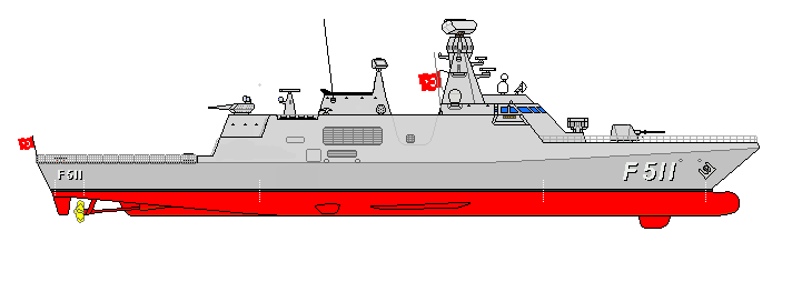

There are possible places, try with 2 x 8 on each side (starboard-port) of RAS station, where located on sides of hangar, nearby to the stepping deck it gets wider to fit 8 cell, or 1 x 8 VLS of self defense length (4.5 m) behind main gun. If i were chosing, i would spare the spot behind the main gun for 1 x RAM launcher, replace RAM with Gökdeniz, install MAR-D as secondary X band search radar on the exhaust funnel, and install 1 more AKR on the secondary mast before the Gökdeniz.
So this way, there would be 2 search radar one S, one X band combined to 3 AKR (one above the bridge, one on the second mast, one on Gökdeniz), 2 x 8 VLS for ESSM, RAM and Gökdeniz as dual CIWS.
I know this is not practically possible but with a new design stretched to 105-107 meters, all those can fit.
Worked a bit more, added 1x 8 cell VLS on each side, and added Mar-D
however,it has some technical issues since it is not an easy job to add VLS on existing platforms by cutting holes on the decks especiall when it is on sides of hangar and near to the hull, it needs more job,specific structural parts to alight with, or lean on.
2nd search radar Mar-D in here, has some issues with angle.
Weight balance is not assured.
It is more logical to expand the hull from midst and add vls between exhaust and SSM, but that would shift the bridge and operation room towards outer than the mid, thus will lower sea-worthiness.

It can be moved further, but i thin 0.75 - 1 length of RAM launcher would be sufficient.
Which program did you use to draw?
THX
People might find exaggerating to put MAR-D and Gökdeniz and moving RAM front side.
But i think just two side MK48 launchers with ESSM are necessary at first with minimum construction works.
Huge radar without ESSMs kinda automobile without tires:)
THX
THX
Paint :)
It was from Çınar Çakmak's shipbucket, and i modified it with parts from his drawings or from Shipbucket.
THX
I think Mk48 or newer version Mk56 has penetration in deck from that perspective it requires the same work of amount. It requires less penetration but i don't know why Turkey is interested in Strike length which requires a lot of penetration and support, instead of Self-defense length (might be a reason to choose it, for SM2 maybe).
If it has got APAR i would definitely say it is a waste without ESSM with full guidance, but with Smart-S or Mar-D (X) it is decent if it doesn't have ESSM.

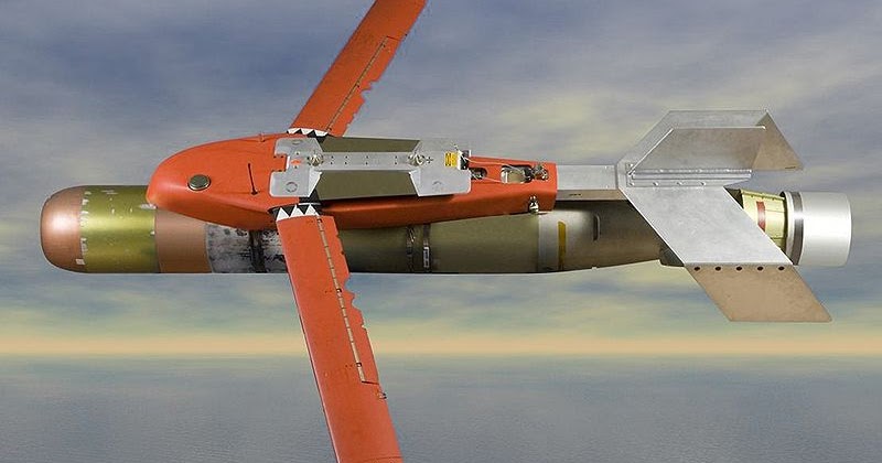

Guys what did i find , it looks like our KGKs.
They'll turn their P8s into air frigates.
Winged Torpedoes to Kill Subs at Long-Range...​
Mark 54 lightweight torpedo that will enable the weapon to glide through the air from altitudes as high as 30,000 feet (9,1 km) and enable the Boeing P-8A Poseidon maritime patrol jet to attack enemy submarines from long ranges. (image : US Navy)

Once We already had three MELTEM projects which were submarine chasers, would it possible loading them with those winged torpedos.
Without the HAAWC kit, a Mark 54 Torpedo has to be dropped from an aircraft at low altitude, usually no higher than 100 feet...

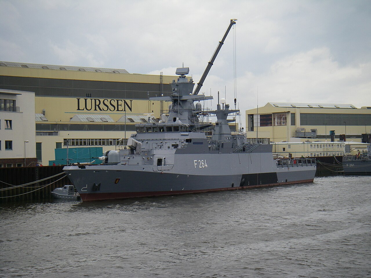

German corvette Ludwigshafen am Rhein
Good example of frontal RAM system for ADA class.

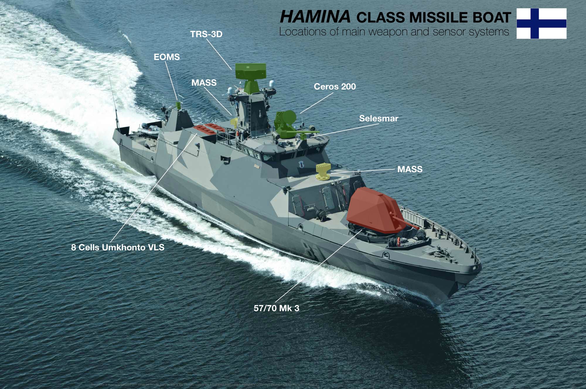

Umkhonto uses hot launch from a tube. Crazy.
