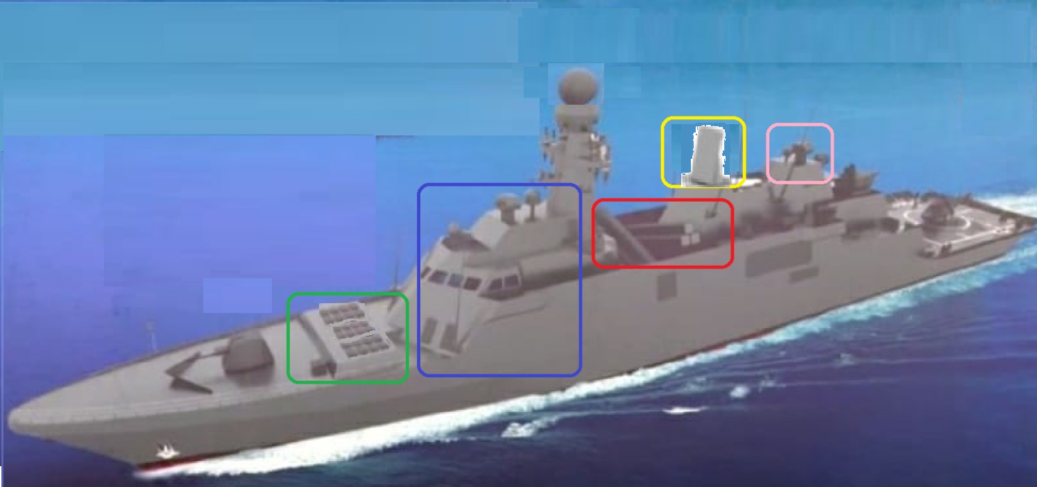

Cheap air defence solution for littoral navies based milgem jinnah frigate
24x vls for 16x siper + 32x essm/g-40.
Aselsan teirs one plate like smar-l for s band long range radar. (yellow square)
100-120 km ranged x band mar-d in baloon dome for multifunction radar.
Aselsan akr-d for midcourse guide for siper in pink square.
@Brave Janissary this is just one of the ideas i have scratched recently upon your question in the other thread.
Moved RAM to the fore on elavated platform, gökdeniz located in place of RAM, vision of the bridge in uninterrupted.
Credits to the çınar çakmak, for the drawings of systems and the ship.
Turko
CIWS such as Phalanx especially Millenium gun and of course Gökdeniz are much more efficient than RAM systems. Remember some AshM are supersonic and then last phase the missiles burst 200-300 little tiny pieces. İn This situations just Gökdeniz could save the ship, thanks to 3p ammo barrage.
Don't be too harsh on RAM, RAM and CIWS are best to be used together, on 1 to 1 basis RAM is better, but more expensive solution. American Aircraft carries uses RAM, CIWS and also ESSM for self protection

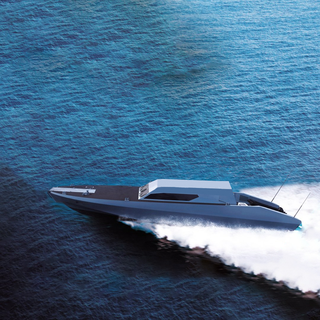

@UkroTurk what would be your ideal weapon station on ARES 80 SAT boat, let's say scenario is to capture enemy positions on an Island.
Here's clean slate ARES 80 SAT -
For me, 35mm Navalised KORHAN turret would be ideal
P

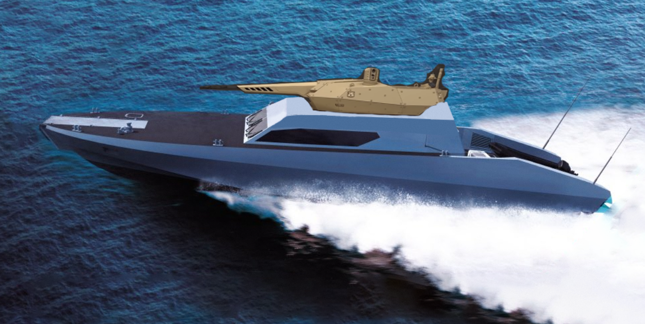

Put gökdeniz in place of the quad-launcher, fits much better :) + AKR on top of the bridge with MAR-D on mast. Gökdeniz will have its own FCR.
Additional quad - 8 packed sungur launchers can be added at the rear in place of mine laying rails, and 4-8 MrAshM in place of Anti submarine rockets -depth charges.
And vola, it is not an ASW patrol boat anymore. :)

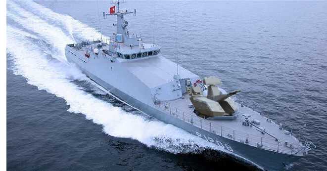

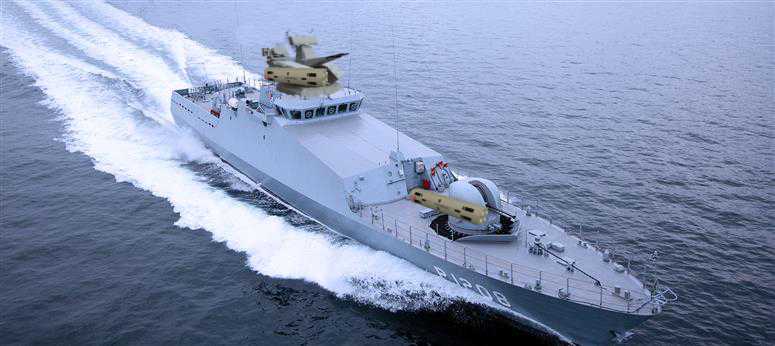

There was a boat model with cockerill turret for İndonesia
20180731023811-tank-boat-antasena-alutsista-canggih-buatan-indonesia-dilirik-rusia%20(1).jpg
For retaking our occupied islands , i would prefer AMOS mortar boats.
very similar to our tank boat
I think this is the model which was shown in fairs (hull 214), is it the land-test unit or actual prototype which is operational at sea?
