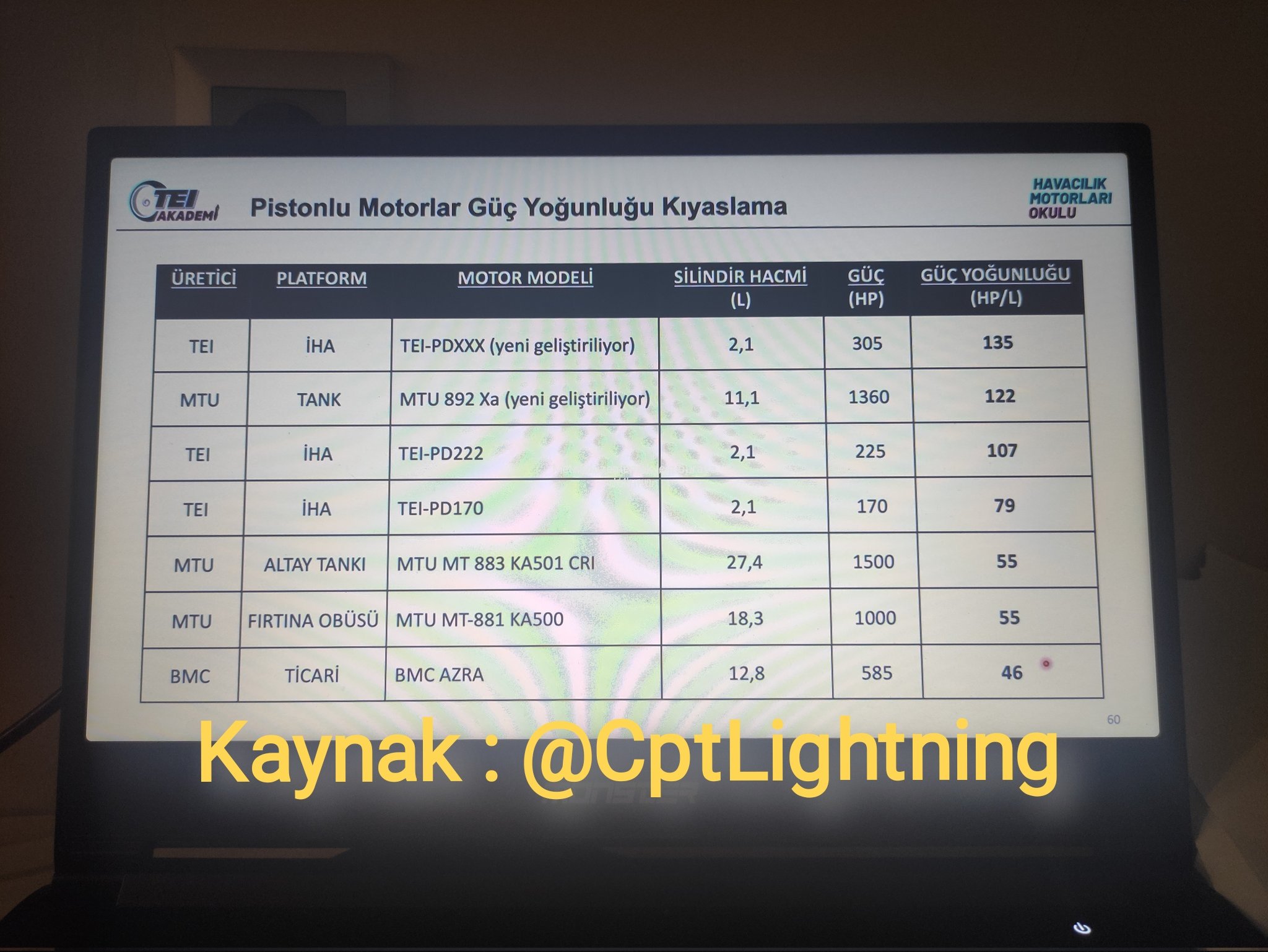

Question: What is the hp of the next power TEI diesel engine up to the PD225;
Bürküt
Defence News Editor
1,174
61 2,184
Question: What is the hp of the next power TEI diesel up to the TD225;
There is a post that Sayın Cabatlı shared in time
15 8,751
I was testing knowledge of people, but you seem to have a cheat sheet, :cautious:.
15 8,751
This is one sweet engine you can find many uses for; a civilian plane using a couple of these 305hp engines can cruise the world with 6 people on board, what a dream.
