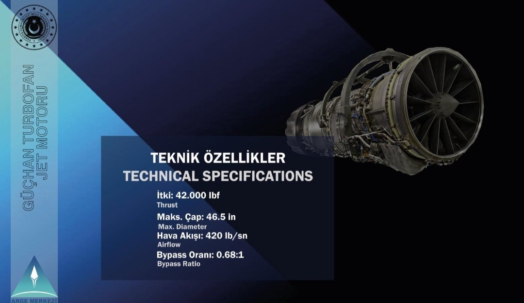

P.S: I dont want to think about anymore but I can't help it. That so called 42.5k and Helo engines still gave me shitty taste. Mr Akşit shows that how engine is built. Not to come out with a foreign engine or stolen pictures and say we did it, like everyone else is fool enough to believe it

During the interview with Tolga Özbek when talking about TF6000 Mahmut Akşit said "This is a simplified, first version of the engine."
Many commentators said TF6000 is as big as F404 so it needs to have higher thrust . Hopefully much powerful versions (8000-10000 lbf) will arrive. A 10.000 lbf dry -16600 wet variant could easily power Hurjet or future Kızılelma variants.

Why many people in this forum are criticizing Gushhan Engine?! If Turkeye can make some changes on an engine that it knows how to produce abd make it more powerful with some structural changes it is enough work to call it new engine. In case the U.S did what it always do and tried to harm the project a ready engine is available.
