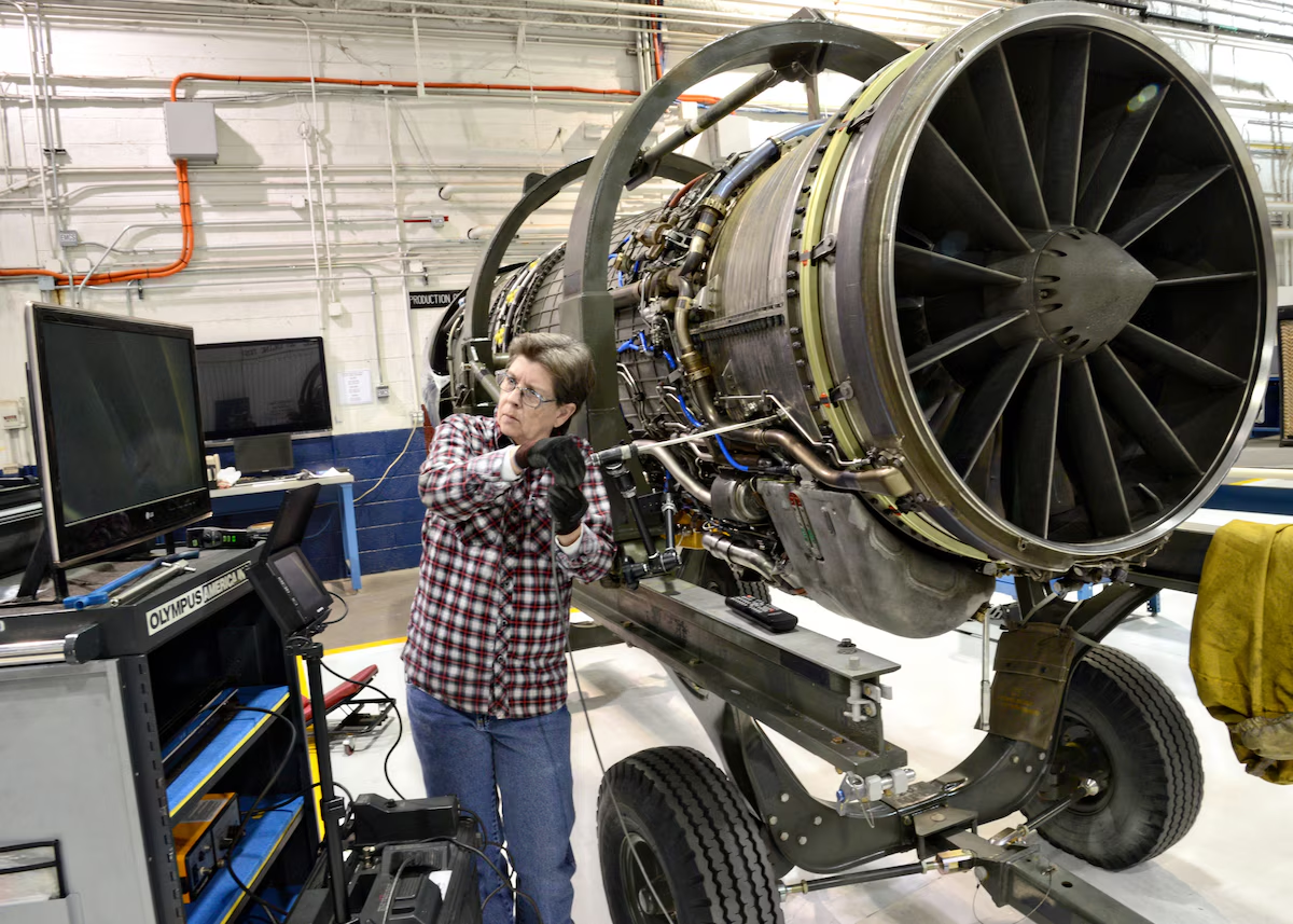

Prof Akşit has made a statement that the new TF35000 engine is producing 80% more thrust at high altitude when compared to a F110 engine.
Well, at say 50000ft altitude, f110 engine’s dry thrust is approximately 3000lbf to 3500lbf compared to it’s sea level dry thrust of 17150lbf.
Also F110’s AB thrust would be between 8000 to 10000lbf at 50000ft; as opposed to it’s sea level thrust of 29000lbf.
So the TF35000 engine is producing around 6300lbf dry thrust at 50000ft. Also it would produce a wet thrust at that high altitude of up to 18000lbf.
For a higher bypass ratio engine that is probably a good achievement.
