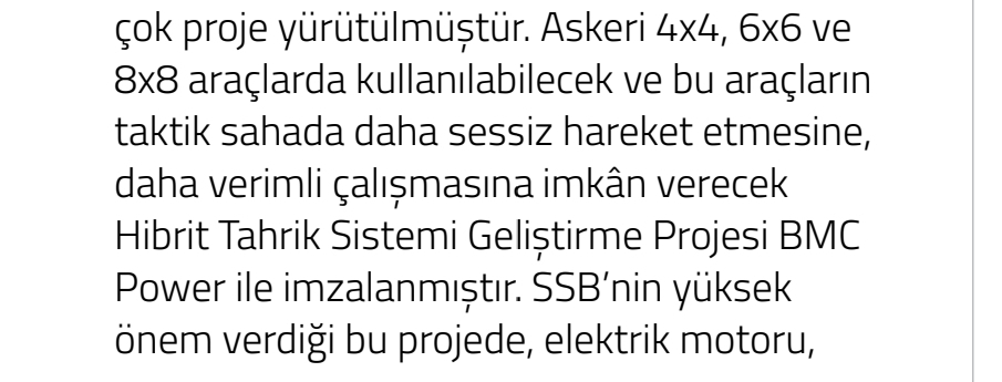

The Hybrid Propulsion System Development Project, which can be used in military 4x4, 6x6 and 8x8 vehicles and will enable these vehicles to move more quietly and operate more efficiently in the tactical field, has been signed with BMC Power. In this project, which SSB attaches great importance, the electric motor, driver and axle systems will be developed locally and nationally. Work has started with the aim of developing Box Type ambulances, which are needed by the Ministry of Health. ASELSAN with equity to equip Armored Combat Carriers with electric traction system funded development project started
I doubt BMC will do anything.
