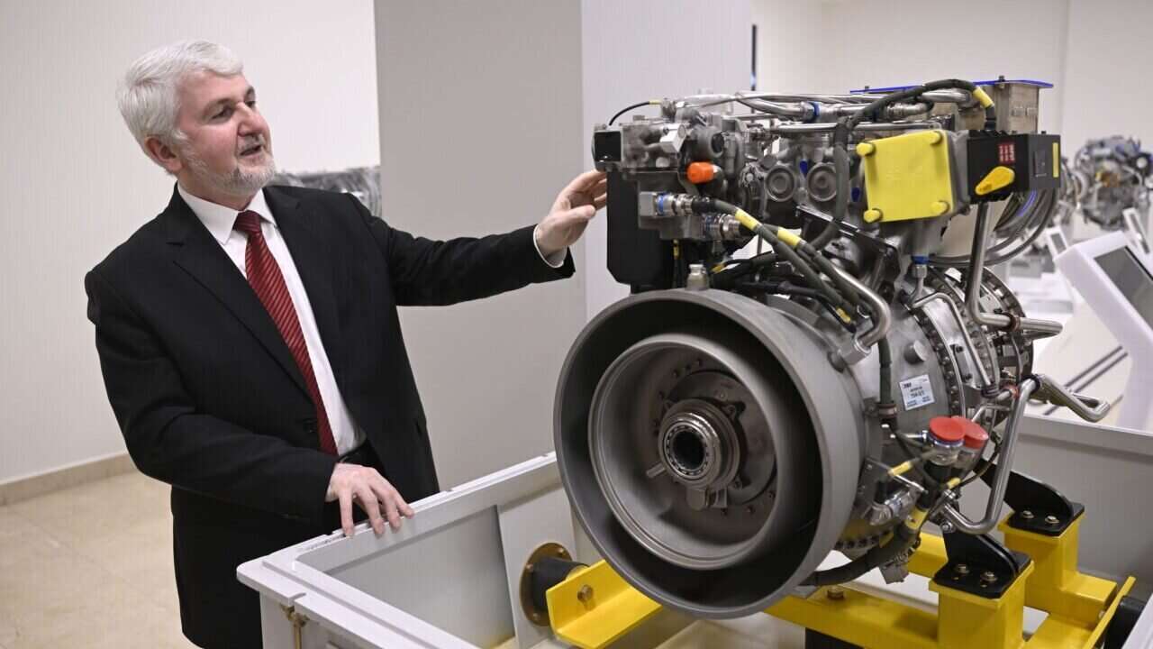

TEI General Manager Mahmut Faruk Akşit:
Domestic engines developed for UAV and helicopter engines started mass production (He is talking about PD series and T700)
We can make the TF6000 flight-ready immediately, but the need is for the TF10000. Work is progressing faster than expected (Very good news the target was conducting the first flight in 2026 it seems like it will be achieved without problems.)
Especially the demands from foreign countries have increased. We can say that the customer is ready before TF10000 is finished
We aim for KAAN to fly with a domestic engine in 2029-2030. “Eurojet's engine took 17 years. If we did it in 17 years, they would lynch us.
