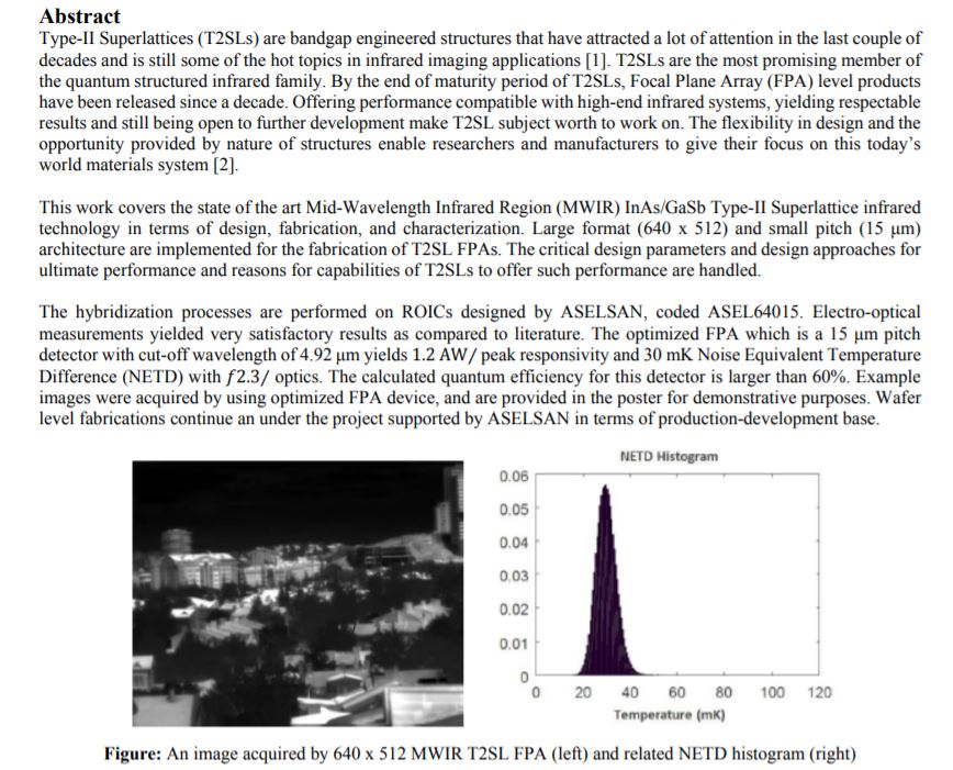

An informative article about T2SL MWIR detectors
I shared an article on the subject here.
