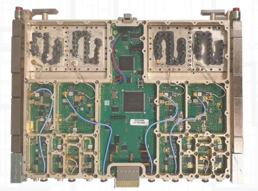

It is the realization of TÜBİTAK BİLGEM's 2-18 GHz frequency band, dual channel 750 MHz bandwidth Frequency Sub-Inverter Card developed for electronic warfare systems.
