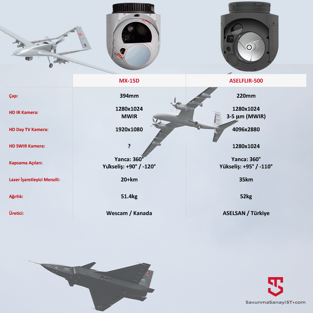

Is an Aselflir-500 really prices more than $1 million?
1 million $ is a very competitive export price for a system like Aselflir-500. Most countries can't even get an export license from Western countries for a laser designator with a power output similar to that of Aselflir-500. Customers will get a camera with better image performance, a longer-range laser designator, and an HD SWIR sensor which is missing in the MX-15.
