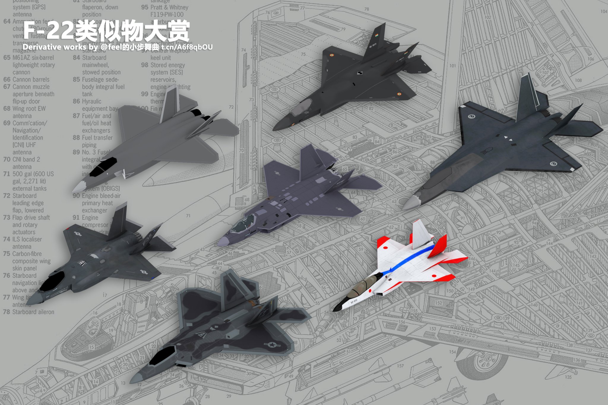

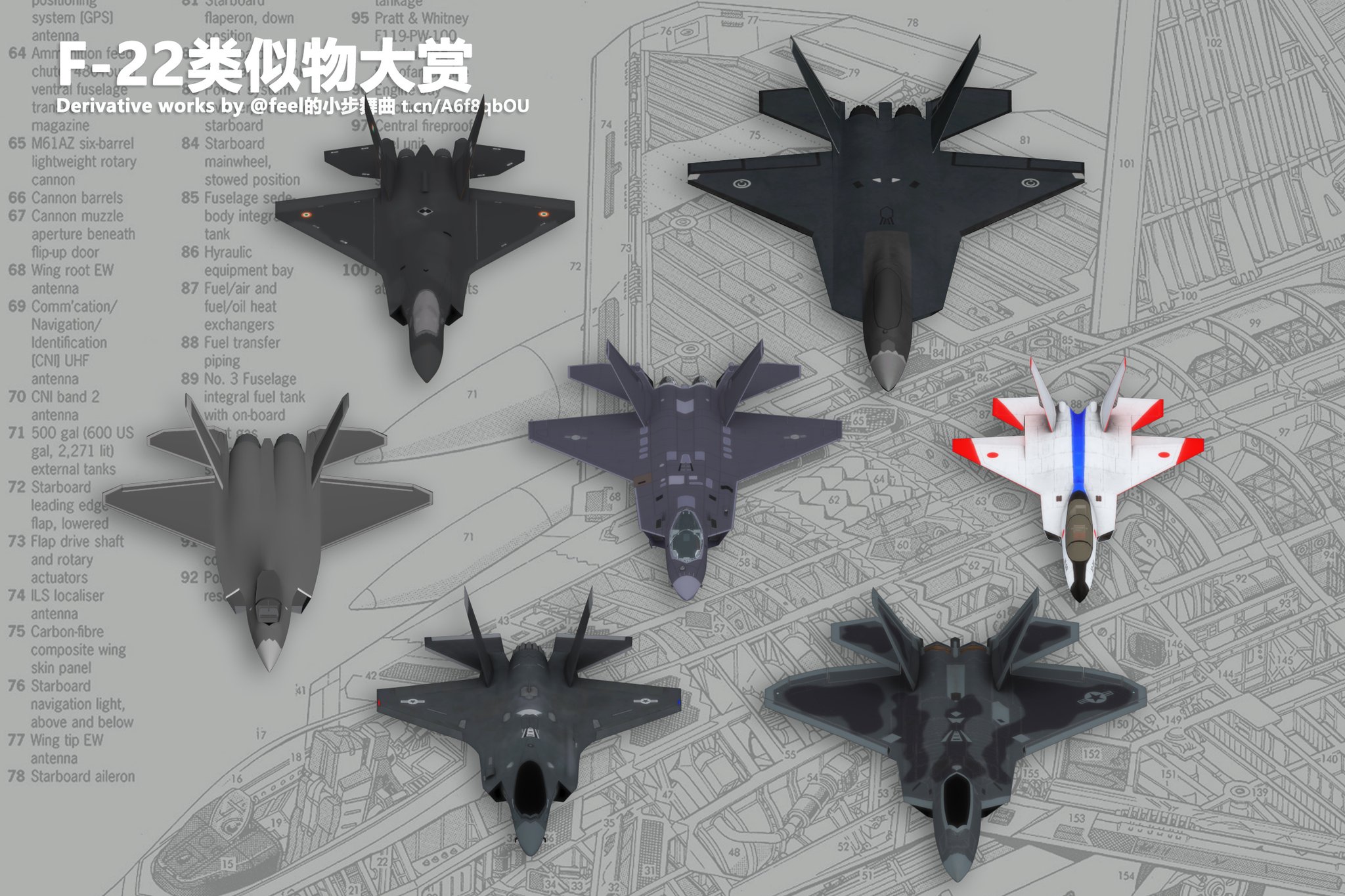

The size of the fighter MMU compared to other fifth-generation fighters .

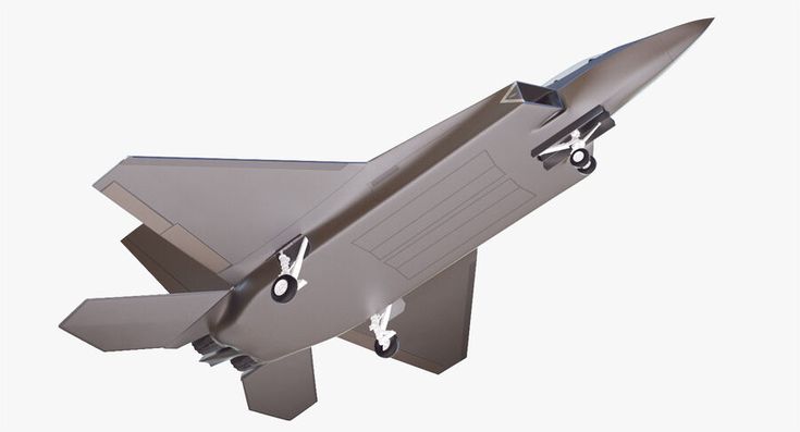

Tempest and Japanese F-X are joining forces, goal is to have one aircraft with minor adaptions for Japan and Britain.

The Japanese one is almost half the size of MMU.
Actual F-X fighter jet will be powered by 2 F119-class engines, albeit smaller and lighter. It is your average heavyweight fighter, not much smaller than the MMU, capable of carrying 8 AAM missiles internally.
