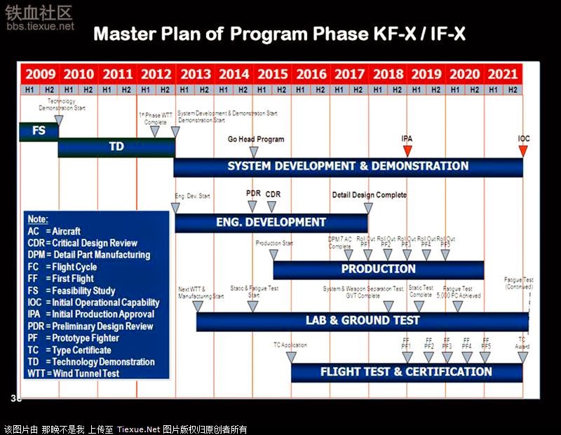

From what he said PDR (Preliminary Design Review) will commence in 2021. PDR is basic design that later after basic design is approved, the process needs to be followed by Critical Design Phase. Critical Design phase needs a lot of designers since they will make a lot of parts design.

After PDR phase are passed, The Critical design and prototype production phase are started in similar times in schedules because Qualification (for ending the detail design phase) of aircrafts need to be done with this prototype.
In master plans of S. Kores, It was envisaged to commence production of first KFX with 5-6 month differences than the date PDR completed. TfX PDR will commence in April 2021 and production (first cutting) will commence in Sept 2021.
Yup, that plan is delayed because after KAI and LM join, the C 103 design is still being developed so the program get longer than it should be.
The technology demonstration phase has also resulted with C 103 design. In 2015 KAI and LM join the program. C 103 design is later refined and become C 109 design which is bigger than C 103 but the shape is not really different.
Preliminary Design Phase was completed in July 2018 and it is the start of Critical Design Phase. In September 2019 there is CDR (Critical Design Review) and it shows critical design phase has almost been completed.
Talking about first part of KFX/IFX production yes it is started about 6 month earlier than CDR, but it is only a small part. So I think you are right.

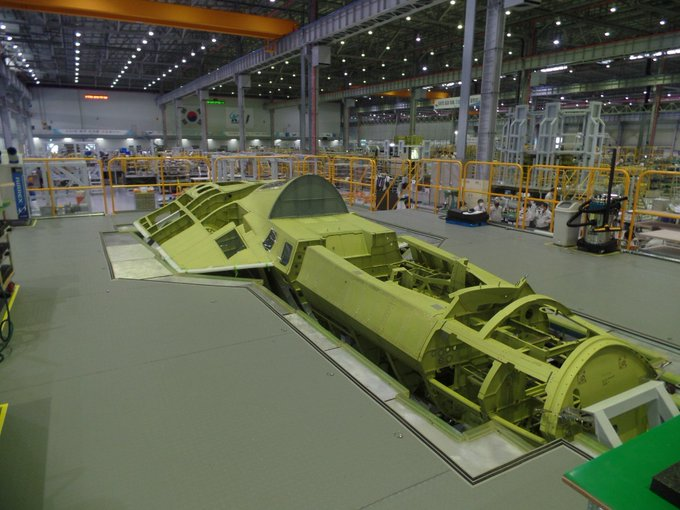

I was almost getting the idea that the skin comes integral with the structure but obviously it does not. Seems like skin parts are attached after the structure is built. Parts are not monocoque but piecebuilt.

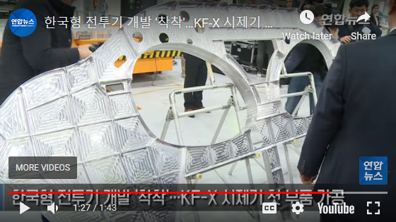

Do you have any info about this bulkhead ? Which institute produced it ? Was it produced with 3D printing or titanium pressing methods ?
I believe they make it in KAI facility. I dont think production facility uses 3 D printing, there is no news saying thing like that, but yes, KFX/IFX uses titanium.

The thing that I know is that they use FASS technique (Fuselage Automated Splice System)
