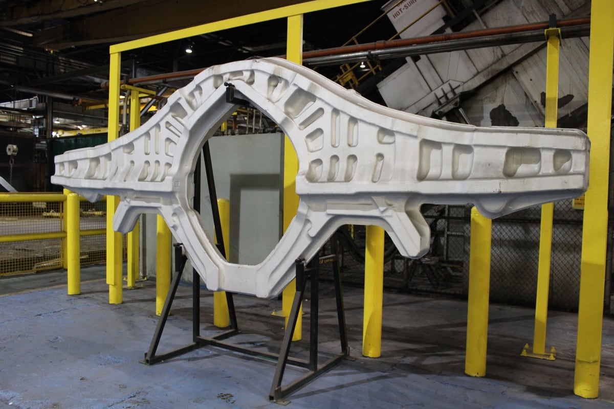

Do you have any info about this bulkhead ? Which institute produced it ? Was it produced with 3D printing or titanium pressing methods ?
My opinion As Engineer who works with Standart Stampings machines, That Bulkhead can't be produce with usual stamping methods, And You check You can see starking contrast to F35/F22 bulkheads compare to KFX.
Details of this design can be achived with 3D Printing.
F35 Bulkhead
F22 Bulkhead
F-22-bulkhead-forging-3000-kg-17-m-high-by-4m-wide-Source-J-Rossow-Wyman-Gordon.ppm
F35 Bulkhead
F22 Bulkhead
Deep and sharp insets are to blame I guess.
F35 Bulkhead
F22 Bulkhead
You as a prof in the business i have a question for you, will we able to press like that within 10 years?
I work with these machines daily and Stamping Methods changed very little in the Last 100 years. Like @Yasar pointed out Deep and Sharp lines cant be done with stamping method. And These sort of Machines can only be acquired with Governmental support. And We can clearly understand from Mr Kotil's interview This isnt on the agenda for Now. So No I dont See any Turkish company acquering These technology in the foreseeable future.

Looking at the KFX bulkhead it is not presswork at all, it is completely routed from a thick slab of metal.

How will Aluminium resist to high pressures at high speeds?
Aluminum alloys are even used in engine blocks so they have a respectable strength. But at the end what counts is the material strength to weight ratio in aviation. Aluminum is an easy to process metal so it is an option to fall back to if better (?) choices can not be accessed to. But why does K-FX use routed aluminum?

7085-T7452 = Aluminium alloy
Ti-6-4Eli = Titanium
It seems F35 central bulkhead are produced with single pieces forging titanium and Rest of the Bulkheads are produced with Aluminium for weight saving. (y)

They use aluminium to keep the cost low, since a titanium part of equal strength is lighter but is much more expensive and difficult to produce. Lockheed even had to redesign the F-35B bulkhead and change it from titanium to aluminium even though this made the plane heavier: link
