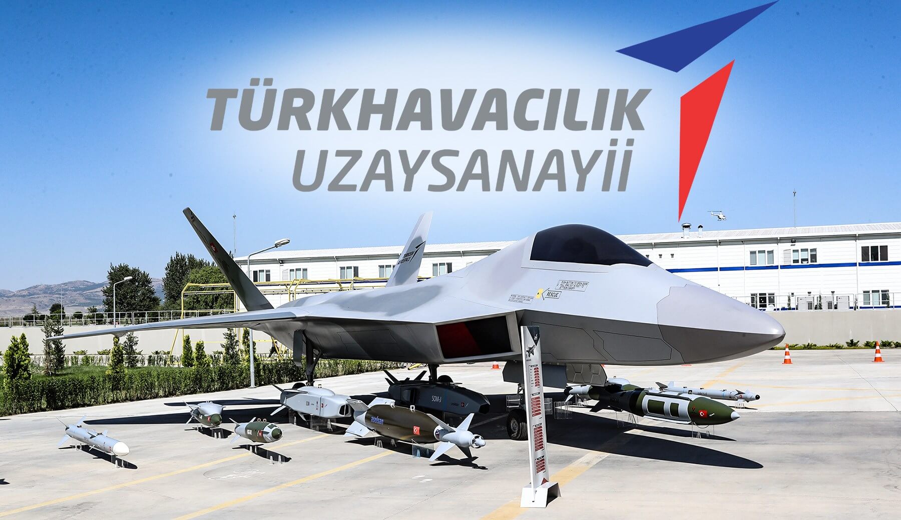

MMU is not just one aeroplane but a family of planes with variations.
Who is saying that officials said it?
Are you expecting members here to just share the news they heard from someone else and not share their own thoughts. That would be stupid for a forum wouldn't it.
With the unmanned versions of some versions of MMU added they would not just be a family of planes but a clan of them. When you can make all the elements of making a plane yourself you can make many variations of it with 90% commonality. It would be stupid to think a plane is one and only and it will just stop there.
Stop downplaying Turkey's capabilities, when we can make one, we can make many.
Bro, for the last time.
Sharing your own thoughts is ofcourse no problem. Of course you are going to share your thoughts and ideas. No one is against that. For many many times we said we have freedom of expression in our forum.
^^^However this is not sharing your thoughts.
For the last time, i don't want to warn or ban anybody. I never wanted that but you are giving me no other choice. Please, don't do this.
I think there is a slight misunderstanding here. We certainly don't want this forum to be filled with false information, so Sinan does have a point, but what Zafer is saying may turn out to be correct, but it is presented as a fact rather than a speculation (in the first post)
What we know is MMU may start as a 4.5 gen, before entering service as a 5th gen fighter. However it is often touted as being 5+, meaning that there is room for future upgrades.
I wouldn't really call this a family, more of a planned evolution. Also, we don't know much about its autonomous capabilities, who knows, Goksungur and TAI's future fighter drones may be prioritised instead, and MMU may rely mainly on human input, with some AI to aid the pilot.
We don't really know if MMU will have specific variants, but chances are it will be solely focused on air superiority like the F-22, along with the capability to strike ground targets. Though it must be mentioned that by 2030 we should have supersonic drones for the purpose of ground attack.
MMU won't be like the F-35 family, with the A, B & C variants. Neither will it be like the F-18 family, with specialized variants like the Growler (for EW). No, it'll be Turkey's version of the F-22 and its design will be homed in until it's perfect, perhaps being heavily modified decades later to keep up with the latest tech.
MMU won't have a twin seat variant, the Hurjet will likely suffice as an advanced jet trainer. As for a version which can launch from a carrier, who knows at this point. This is a possibility. Truth be told, we are just speculating at this point. But let's not get too ahead of ourselves.
Our drones will fill in niches and each drone will be part of its own family. Meanwhile the MMU is very early in its development, but everything indicates that it will be a platform solely built for one purpose and the entire fleet will likely be upgraded all to the same specification when the time comes.
Yes, like Zafer said, it could become a family. But everything currently indicates that it won't. Just to be clear Zafer isn't the only one who said this, I've seen it on a Turkish YouTube channel.
Now let me just turn everything I said upside down... If MMU is fully autonomous, we could see a "cockpitless" version, which could then be developed into a family of drones. But let me flip the switch once again. Would this even be necassary with the Goksungur and MIUS coming up? Probably not.
The future is going to favour drones. Air superiority fighters will be the last to transition to be unmanned because as of now a pilot is still superior to AI (this could already be changing). But everything else such as attack aircraft, bombers, strike-fighters, EW aircraft will all be drones surprisingly soon. Expect a single drone platform to diversify into many variants. Meanwhile, as mentioned earlier, the only niche which will be dominated by manned aircraft will be air superiority fighters... until AI catches up. This greatly limits the amount of variants we could expect for the MMU "family"
In my opinion this is the most variation I can see:
  1. MMU standard variant
  2. MMU carrier variant
Continuous upgrades to both, in blocks/phases, different loadouts depending on the mission.

Actually Ismail Demir said that the MMU will be produced in blocks. First batch will be 4.5gen and replace the older F16's. I think this is a logical step but I don't think we can say that MMU will be a aircraft family like F35 for now.(It will be strecthing the Ismail Demir's statement) There is no doubt that the navalized version is on consideration but I don't think it will materialized before we have a operational MMU with large numbers. Also we don't have any specification for aircraft carrier yet, MMU could be too big for our possible AC. Hürjet might be more suitable for navalization.(Or a new aircraft based on Hürjet)

Since the TFX is using the F110 or F110-class engine, then it'll basically be an F-15-sized fighter, correct? So, this makes sense for air superiority, deep strike, and maritime operations.
But I'm guessing the Turkish Air Force is investing in the Hurjet as both a LIFT and 'light fighter' -- i.e., the latter for air defence / air-intercept?
In other words, the work of the F-16 is going split between the 'heavy' roles (via TFX) and the 'light' roles (via Hurjet)?

Well the original plan was to use F35/TFX combination but since the F35 deal is gone I guess the new plan is making the Hurjet fill the F35 role as much as possible(without the network capabilities of F35.) or using TFX variants for different roles.(like F15C and F15E)
To be honest we can't say anything at the moment for future planning because F35 is a unique aircraft(it is a fighter jet with AWAC capabilities) and crucial for Turkish Air Force's future planning. We can only guess how the future of the Turkish Air Force will be structred. It seems though we are still hoping the get the F35 and for that reason we didn't fully commit to the alternative plans.

A deep strike MMU version should have what we can call peer/buddy fuel transfer capability to replenish the striker from a sidekick peer MMU to extend range.This pops the possibility of yet another MMU family member specialized to use all its payload capacity to carry fuel, a tanker MMU per se.

I agree -- the F-35 is incredibly unique.
I think it's the heaviest single-engine fighter (MTOW: 31.7 tons), and tailor-made for deep strike operations.

Burak Ege Bokdil
"Turkey’s indigenous fighter program, dubbed TF-X (or MMU in its Turkish acronym), has been crawling over the past years due to technological failures and issues with know-how transfers. Turkish engineers must first select an engine for the planned aircraft before finalizing the design phase."
