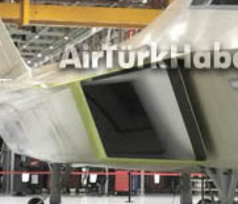

As the expected nose is slightly shorter but wider and overall bigger to accommodate the big radar antenna and all of the electronics. We can clearly see IRST and EOTS at the top and bottom of the nose. Air inlets are different compared to the mock-up. This is expected as no one shows their real inlet design on the mock-up. I like this air inlet design more there is no way to see engine fans, the intake area looks slightly bigger and it is diamond shaped to reduce RCS further. You can see the bump(red) inside the air inlet from the picture and the inlet is slightly rising(green) after the entry part. It looks well-optimized for stealth and 3D fluid dynamics.

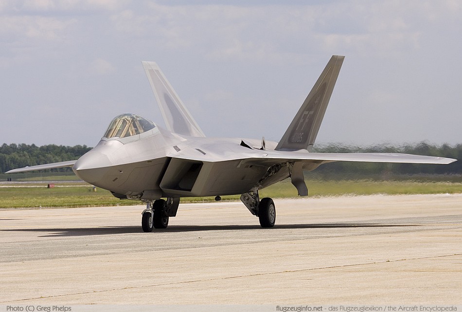

Will the operational TFX have DSI? And can we discuss the advantages/disadvantages of having DSI?
AFAIK, DSI doesn't yield more stealth but it's more efficient at supersonic speeds as it reduces the drag by not having a diverter creating shockwaves at the inlet. Moreover, because it's a fixed system, it requires less maintenance. The downsides that I can think of are its complex design and suboptimal performance at subsonic speeds.
F35, J20, AMCA have it, while F22(was old for DSI) and KF-21(not true 5th gen) don't. Should TFX have DSI?

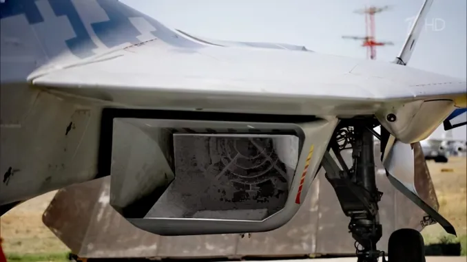

Seriously, the Russians have never used S-duck inlets, except for 1-2 experimental aircraft. I wonder why?
