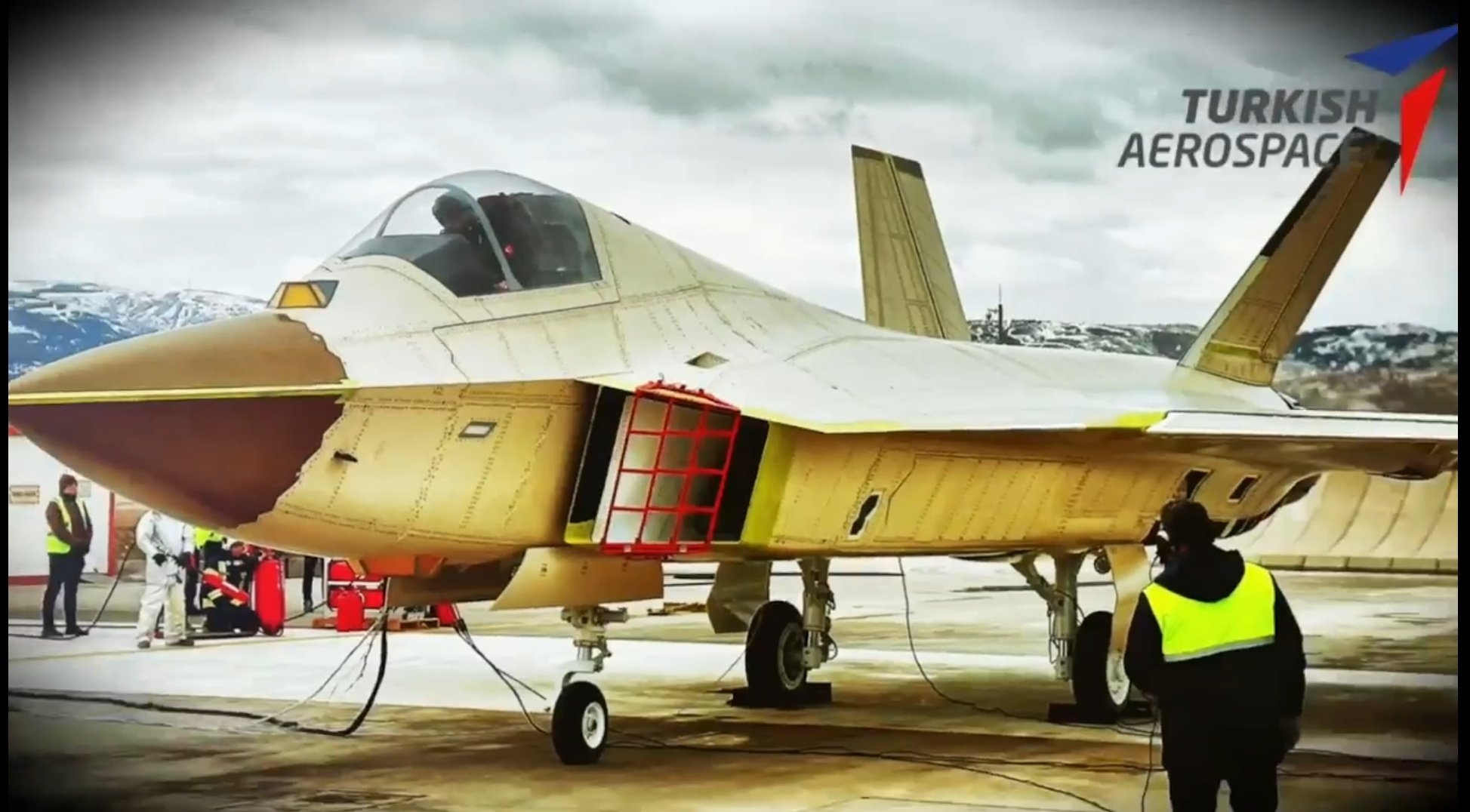

Everything needs to be in harmony aerodynamically. Moving the vertical stabs is a big challenge and probably isn't worth the time and effort. I also believe there is a reason why TAI put them there to begin with.
I noticed that people on other sites have started talking about the vertical stabiliser's position and its likelihood to compromise stealth; maybe 37058444 may have been onto something after all; no other stealth jet has the vertical stabiliser directly over the engine. Saab, who helped to design the TF-X, has released new concept art of a stealth fighter with the vertical stabiliser on the side instead of on the engine.
boredaf
2,316
42 6,815
Why is it so hard to put some trust in the people who designed this plane, checked it in various simulations and tests god knows how many times over some random people on the Internet?
Maybe it doesn't compromise stealth at all, or, maybe it does and they have a reason to believe whatever benefit they saw from placing stabilizers there outweighs the negatives. Maybe armchair aeronautical engineers have no idea what made engineers in TAI choose this design?

Only thing ametures has been saying so far, 'no other stealth aircraft has similar vertical stabilizer placement so it must be bad.'
Which basically translate into 'A new design is problematic if it doesn't resemble the old ones'
That's not an argument. And I am not putting blind faith in TAI. But if you claim something, you need to provide at least a technical argument for it.
11,096
153 22,675
There is no connection between where the vertical stabilisers are and "compromise of stealth"
RCS reduction doesn't care about the surface being at X or translated to say X+5.
It cares about the surface being as planar as possible and then as parallel as possible to other surfaces on the same body to reduce (as far as possible) total radio wave return at any incidence.
The locations of X vs X+5 (regarding an aerodynamic surface of Y area with say location Z1 of its center of lift and Z2 for its center of gravity relative to the whole body) have far more to do with aerodynamic stability + performance optimisation relative to other design needs/drivers
The latter needing spaces and volumes for everything else the aircraft does/has other than flight objectives.
All depends on your aircraft performance objectives and tradeoffs.
You can literally make an F-14 more stealthy for example (while retaining its vertical stabiliser where it is, right on the engine). If you started out with stealth in mind, you would do even better on it.
I have drawn sketches myself for stealth empennages in the past, some included stabilisers on the engines....some didn't (it all depended on spacing and lengths involved of lift, stability and control surfaces of the aircraft as a whole).
If the doubting brainiacs on other sites assert different, maybe invite them here to discuss.

Stealth is not just about radar stealth mate. The more you HIDE your exhaust and nozzles (hottest parts incase people cant figure that out too) better your INFRARED spectrum stealth. It is embarrasing as a Turk to have to spell it out this to so many people on a Turkish forum like this. Not a single person could figure out what I was talking about?
I clearly said heat signature yet they are still talking about radar stealth. And yes knowledgable westerners from other sites are NOW also saying same things including head of the plane being too large thus nonaerodynamic and slower than F22 despite having almost the same thrust. That is not a small MISTAKE either. Can anyone guess for which reasons?
