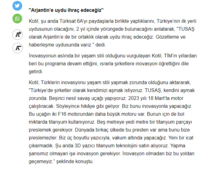

Temel Kotil said that they pressed titanium alloy with 3D printer in the MMU project.

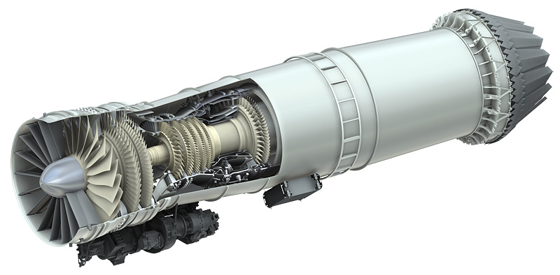

Kotil says by 18th March 2023 the engine of the TFX wil start to work. His sentence about “this plane has a larger engine than 2 F16 engines” does not make sense. I wonder if the serial production engine being designed is something quite different to f110 prototype engines.
RR had built an engine with GE called f136 For the Joint Fighter f35. It was snubbed in favour of f135 of Pratt & Whitney. Can it be a variation of this they are envisaging for the TFX.
F136 engine
No idea what he means by that honestly. The engine of the fighter is bigger than two F-16 engines? What?
Also it would also be interesting to know which varaint of the F110 has been ordered for the Prototypes. 100, 129 or 132?

Most likely the -129 version. Positively sure no -100 and perhaps a slight chance of -132.

If the 5 by 7 meter sheet metal is for the casing of the engine, it is huge, like 159cm diameter if it is used without crinkling it.
However it is bound to get reduced in size to add structural strenght and it would probably be around 125cm or so if 20% reduced due to crinkling, my speculation.

F110-GE-129 is 1.2m diameter and 4.6m in length which is 5.2 m3. 2x as large is thus 10.6 m3. The engine would thus be in the range of 1.4m diameter and 6m+ in length. This is unrealistic IMO but the 5x7 meters sheet is indicative of how large and powerful the TF-X engines will be.

Something tells me that Turkey understates the TF-X capabilities by a lot. This is not going to be a mere 27000lb class engine but more in the league of the F135/136.
The prototypes are definitely f110GE129 engines. But set up for twin use like the f15 eagle engines. These are 29000lbf thrust engines.
The engine design that TR Motor has published is actually similar in design with F110GeE132 engines with their specific blisk design. These engines are 32000lbf thrust engines.
May be he was trying to say it is bigger (in thrust) than the standard f16 engine.
Or may be they have an understanding with Rolls Royce to use the big F136 they had built for the f35!!

That would be great but RR had only 40% share in the F-136; the design is in the control of GE and the US government now, who would never let Turkey have it.
If that is the case then you are correct. However as they have also been in the project they could easily produce an engine like F136 if they wanted to. If you look at thousands of planes that British Airways have used over the years, be it Airbus or Boeing they all have RR engines on them. So they can produce engines of the same caliber without any problems.
It does not have to be the same F136. But a RR variant!
This may not be the case at all. Mr Kotil may have misused a word trying to express the size of the engines to be used - however unlikely!
