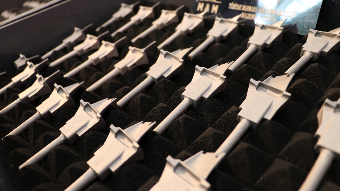

How do you know if current crystal Blades are problem free up to 1600degrees Celcius when the most relevant person Dr Aksit himself says they are good to 1400degrees Celsius?
Advanced thermal barriers will be added and more optimized cooling canals will be drilled on the same single crystal composition.
TS-1400 blades in this picture are good up to 1400 degree celsius as Prof. Akşit says because there are nearly no cooling canals on the blades as it is not needed. The material itself can endure that temperature range without anything fancy. You can also see how thin they are because less force is applied to them. You can compare the thickness of the single crystal blade in the second picture. In short, single crystal blades will be thicker to overcome extra forces due to a bigger diameter of the TFX engine. Advanced cooling canals will be drilled and advanced thermal barrier coatings will be applied which are suitable for the national engine of TFX but the blades will be the same single crystal structure.
This is what blades for the national TF-X engine will look like.

The actual turbine blades of one engine will be different to another engine’s turbine blades, of course.
But below are the blades of the ts1400 engine that they had as a complete set. Presumably a high pressure set and a low pressure set.
So these blades were cut with special cooling channels and a heat resistant application was applied before they performed to required 1400 degrees. When finished they would have similar looking cooling channels to the blade in your second picture. Just smaller.
Here is a GE high pressure turbine blade picture belonging to a turbofan engine. So they do look very different.
Here are some single Crystal turbine blades . They all look different. It is a matter of design.
Bullshit no SCB can withstand temp upto 1400c without TBC and cooling holes.
