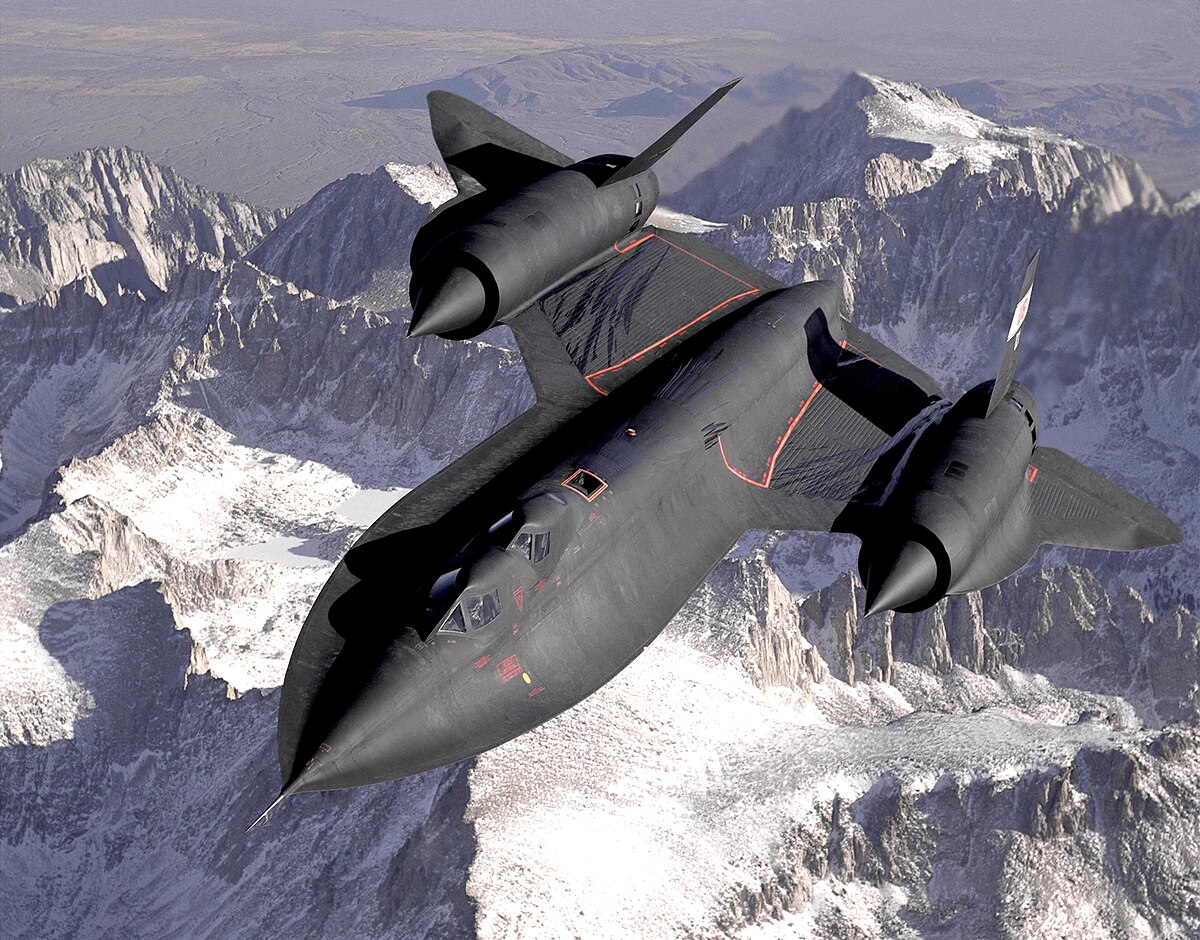

Fighter aircraft have been designed to fly and maneuver at high angles of attack and at high loading conditions. At these high angles of attack, the flow separates from the sharp leading edges of the wing and leading-edge extension (LEX) forming a strong vortical flow that maintains the stability of the aircraft.
To me it looks like that KAAN has chines.
Forward chines also act as leading edge root extensions (LERX) at low speeds and high angles of attack, generating a vortex flow over the inboard wing to stabilise the airflow and increase its speed locally, thus delaying the stall and also providing additional lift.
