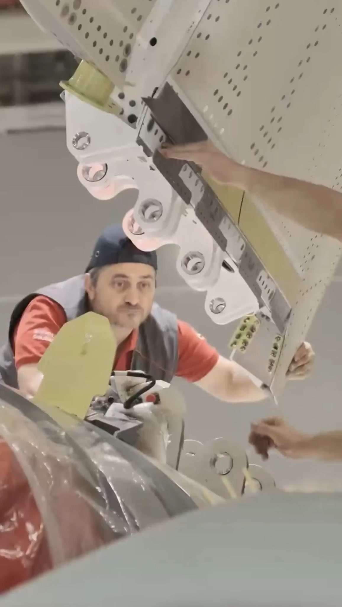

Well, yesterday I just posted you the proof of vertical stabilisers being the same
Why update the brochure when the jet's dimensions will change again in one month? The brochure dimensions are for P1, not P0.
And they do not take into account the height of the cockpit when measuring the height of the aircraft. They take into account the vertical stabilizers.
If they dropped the height of Kaan by 1 meter, they must've changed the position of the vstabs. 1 meter is a massive decrease in height.

I don't get how you are able to get so many things wrong.
The 21x14x6m dimensions were NEVER accurate to begin with, it was just the lazy media department not doing their job.

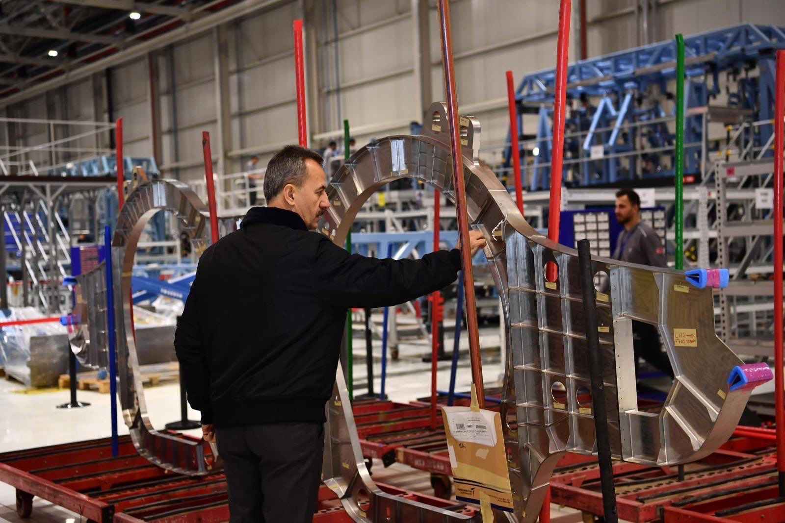

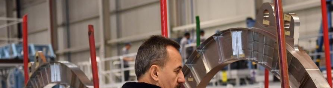

I posted the evidence of vertical stabilisers position being the same for both P0 and P1, look at my original post and try to understand what I explained there,
I remember about people talking about the vertical stabilisers and how they will be moved to the sides, instead of the current over the engine layout.
Well, whoever said that is wrong. Here is the proof:
More clearly this part:
As you can see, it is clearly the mountings for the vertical stabilisers, same as P0;
The first 2 are from the production of P1, you can go check Haluk Görgün's social media. Last one is from the production of P0.
Look at that little extensions (mountings for the vertical stabilisers) with pin holes in them, View attachment 74715
There you go, P1 and P0 has the same vertical stabiliser placement, and there is no need of a further discussion because it would not be factual to argue that they moved the vertical stabilisers.
Kaan's dimensions were never 21x14x6m btw, what's in the brochure is the dimensions for P0, what's funny is that you can also go and check it yourself by taking the F110 as your scale

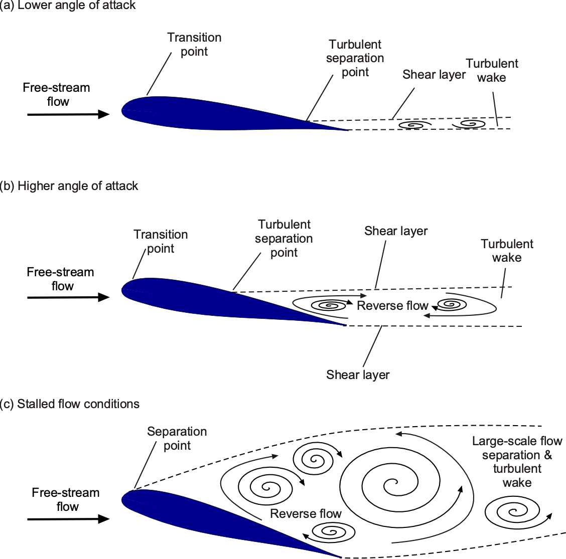

I want to add more information to this, because i find it interesting.
Also guys, vertical stab. is over the engines because of vortex generated by the aircraft. Engines are more seperated from eachother compared to F-22, so the v.stabs end up over the engine.
So let us start with what a vortex is.
In fluid dynamics, a vortex (pl.: vortices or vortexes) is a region in a fluid in which the flow revolves around an axis line, which may be straight or curved.
Do fighter aircraft benefit from vortices?
"Vortex generators are used to delay flow separation by creating streamwise vortices that transport high-momentum fluid into the boundary layer, thereby energizing it and making it more resistant to separation."
— Anderson, John D. "Fundamentals of Aerodynamics." 6th Edition, McGraw-Hill Education, 2016.
Flow separation
Fighter aircraft have been designed to fly and maneuver at high angles of attack and at high loading conditions. At these high angles of attack, the flow separates from the sharp leading edges of the wing and leading-edge extension (LEX) forming a strong vortical flow that maintains the stability of the aircraft.
To me it looks like that KAAN has chines.
Forward chines also act as leading edge root extensions (LERX) at low speeds and high angles of attack, generating a vortex flow over the inboard wing to stabilise the airflow and increase its speed locally, thus delaying the stall and also providing additional lift.
Do vortices have negative effects? (F-18 as an example)
However, the leading-edge vortices break down upstream of the vertical tails. The breakdown flow impinges upon the vertical tail surfaces causing severe structural fatigue and has lead to their premature fatigue failure, costing millions of dollars every year for inspections and repairs. The accurate prediction and analysis of the tail buffet problem remains a prime objective to improve the design and maneuverability of the new generation of fighter aircraft.
Vertical tail buffeting at high angles of attack is a phenomenon associated with the impact of vortical flows generated by the aircraft on the fins. This poses a serious problem for both single- and twin-tail fighter aircraft from the point of view of combat maneuverability and structural integrity.
So basically, the vertical stabilizers of KAAN are mounted on top of the engines to minimize tail buffeting.
