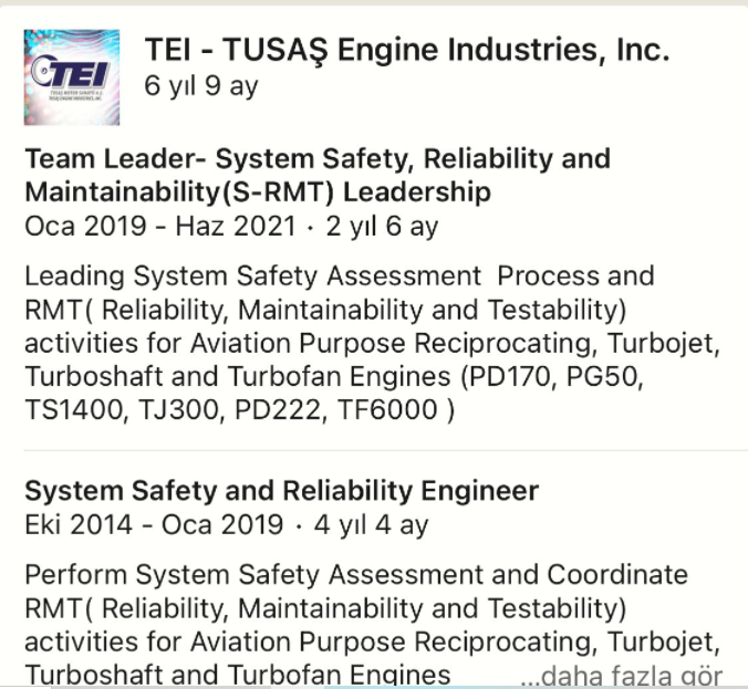

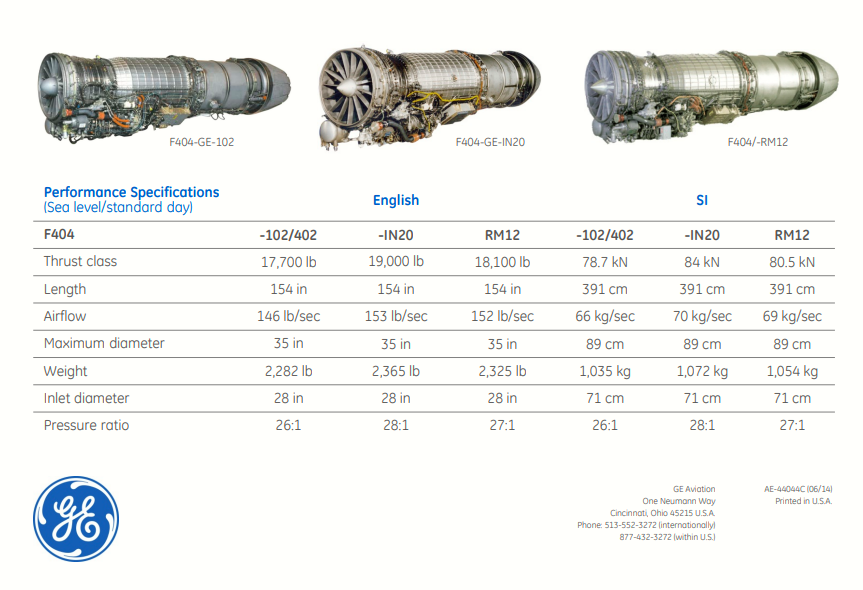

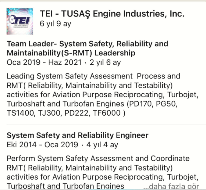

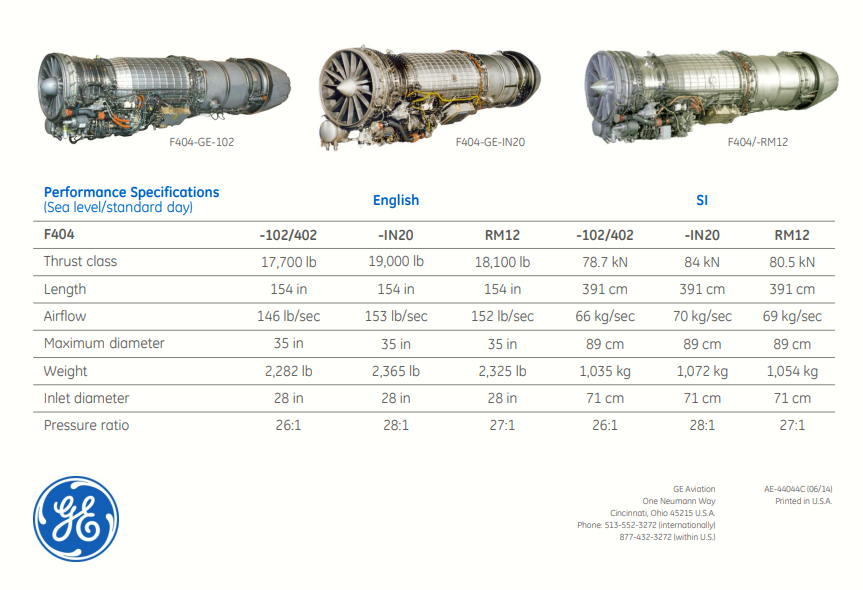

It is predicted that it can provide a maximum thrust of 27 kN for the TF-6000. The GE F404 produces 3 times more power than the TF-6000. (It is possible to estimate the size of the UCAV from here.) Therefore, considering that the engine is quite small, other options are not possible for TAI.
On the other hand, it is not 1-2 years for the TF-6000 project. We guess it's older.

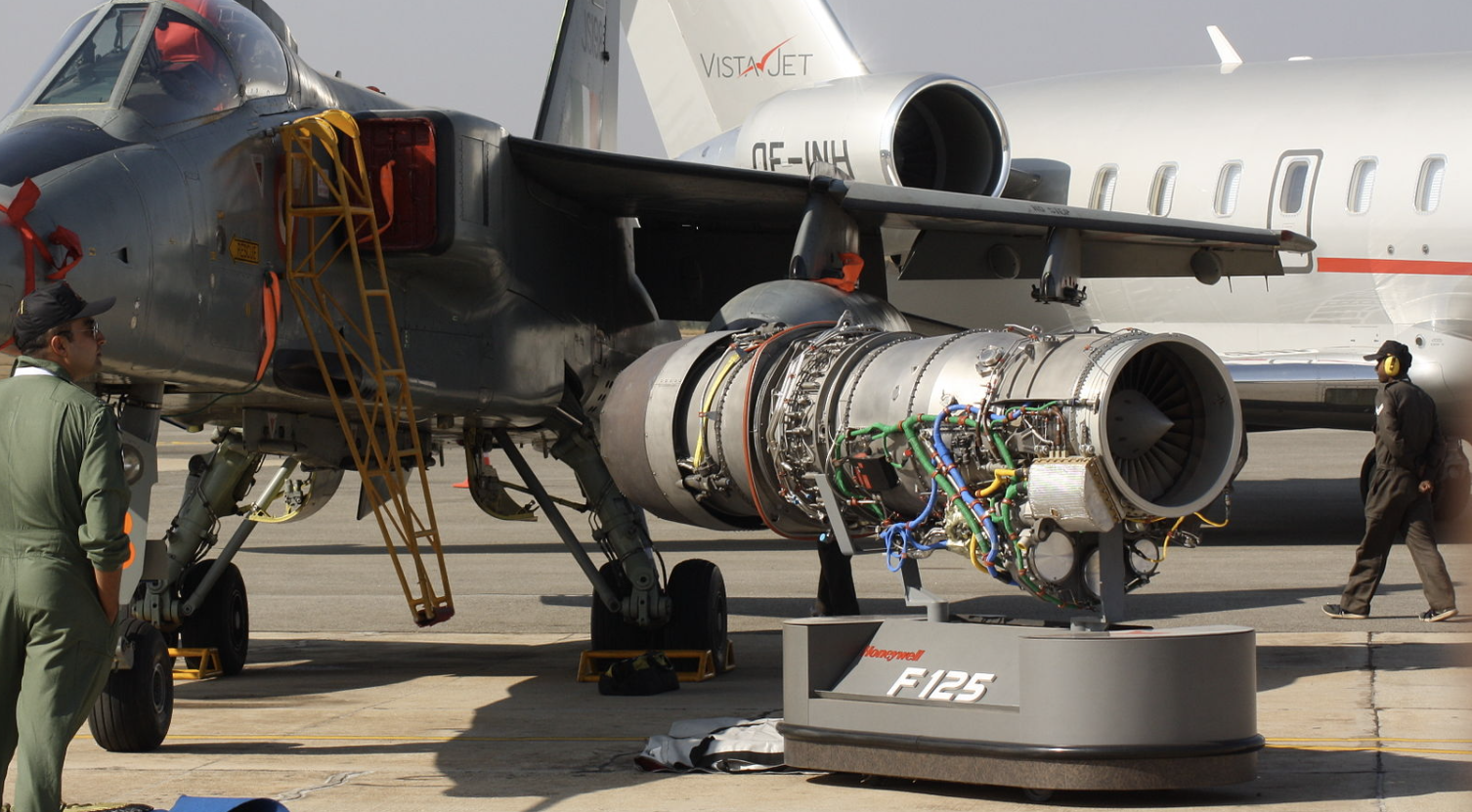

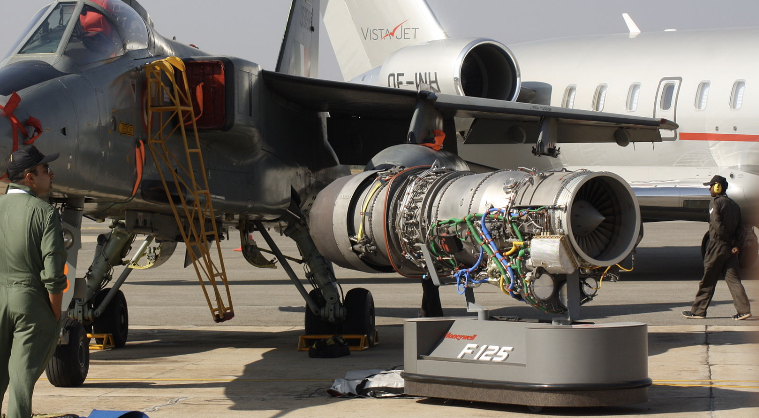

If it is 6000lb thrust engine, it's not an engine that's built up from TS1400 and likely an axial flow engine.
A turbofan engine based from TS1400 core would output around 1500-2000lb of thrust, and share similar dimensions as GE Honda HF120.
Honeywell F125 with 6280lb of thrust

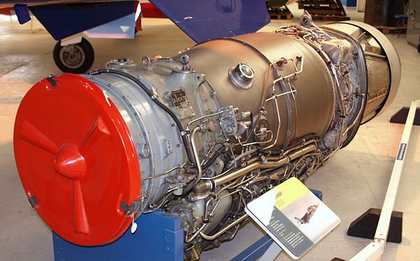

Ibrahim Sunnetci had mentioned in one of his articles that the ts1400 core and body would yield a turbofan engine with a thrust level of 6000lbf dry and 9-10000lbf with AB. Size wise it would be quite a demanding case to make the said power level. But can be done by extending the length of the engine. (As in RR Adour)
Of course the innards of the ts1400 would have to be extensively altered to allow an axial flow compressor and turbine section as opposed to the radial flow of ts1400.
Also the dry thrust and the after burner thrust has to be made clear. If the quoted thrust is dry 6000lbf then we are talking about an engine with a power level of 9-10000lbf thrust.
Any jet propulsion engine has to be axial flow in order to create thrust. Some of the sections may be radial, to give better efficiency as radial flow improves heat propagation. But in essence a turbofan (or a turbo jet) is an axial flow gas turbine.

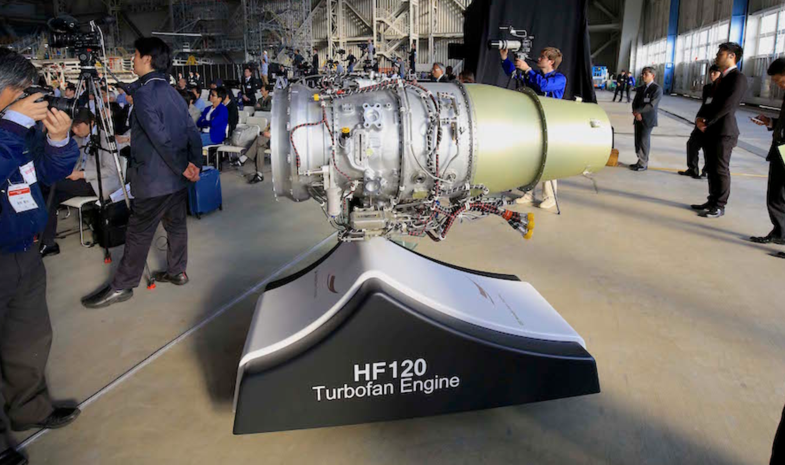

The problem is HF120 has a relatively high bypass ratio 2.9:1 and very low turbine inlet temperature 860C, also it has reverse combustion chamber. Since its not meant for military applications but business jets, i think it is not wise to set it as an example for ts1400 core just because it has similar diameter.
Edit: it turns out ts1400 also has reverse combustion chamber.
