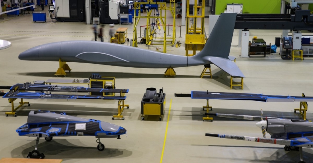

Act like one how ?

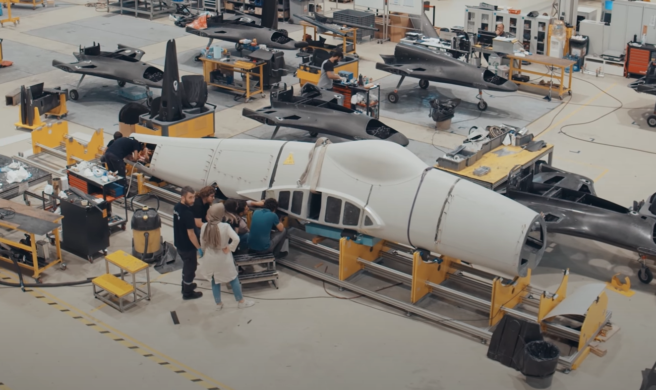

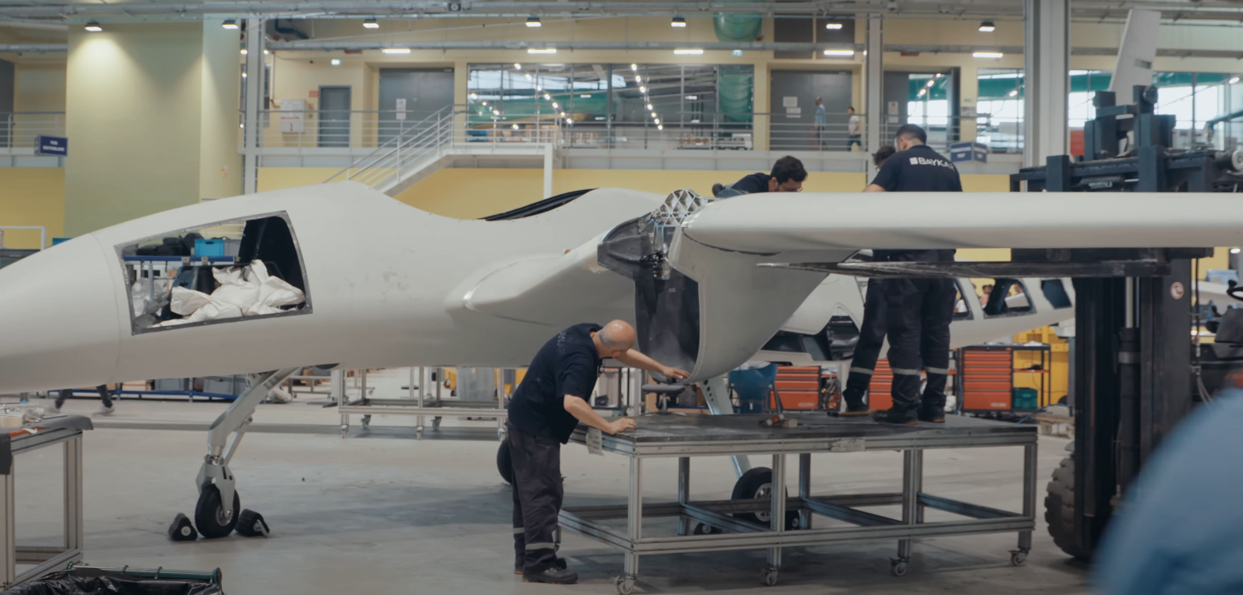

What you are seeing is a method BaykarTech uses to make aircrafts, they fully encapsulate mouldings with carbon-fibre with the underpinnings aluminium/steel structure, wait for the mould to set then go back and cut out sections for access panels and necessary ports for spars to slot through. We've seen this method with TB2, Akinci and here with Kizilelma.
It's actually very clever method in which to make composite aircraft, less screws and panels involved - but a lot of accurate slicing involved.
This
Became this
I have to admit i guessed the same with Akinci model when i saw this pic for the first time which turned out to be a wrong assesment from my side but there are still more issues with the Kizilelma model which makes me believe that its more a display model rather than a working prototype.
As someone else noted before, the gaps between body and wings are just too wide, obviously no precision machining involved in there, second issue is the rear section where the engine is supposed to be, it still looks too thin, compare it to your picture of F-35, that part is obviously reinforced with metal, its not just plan composite sheet.

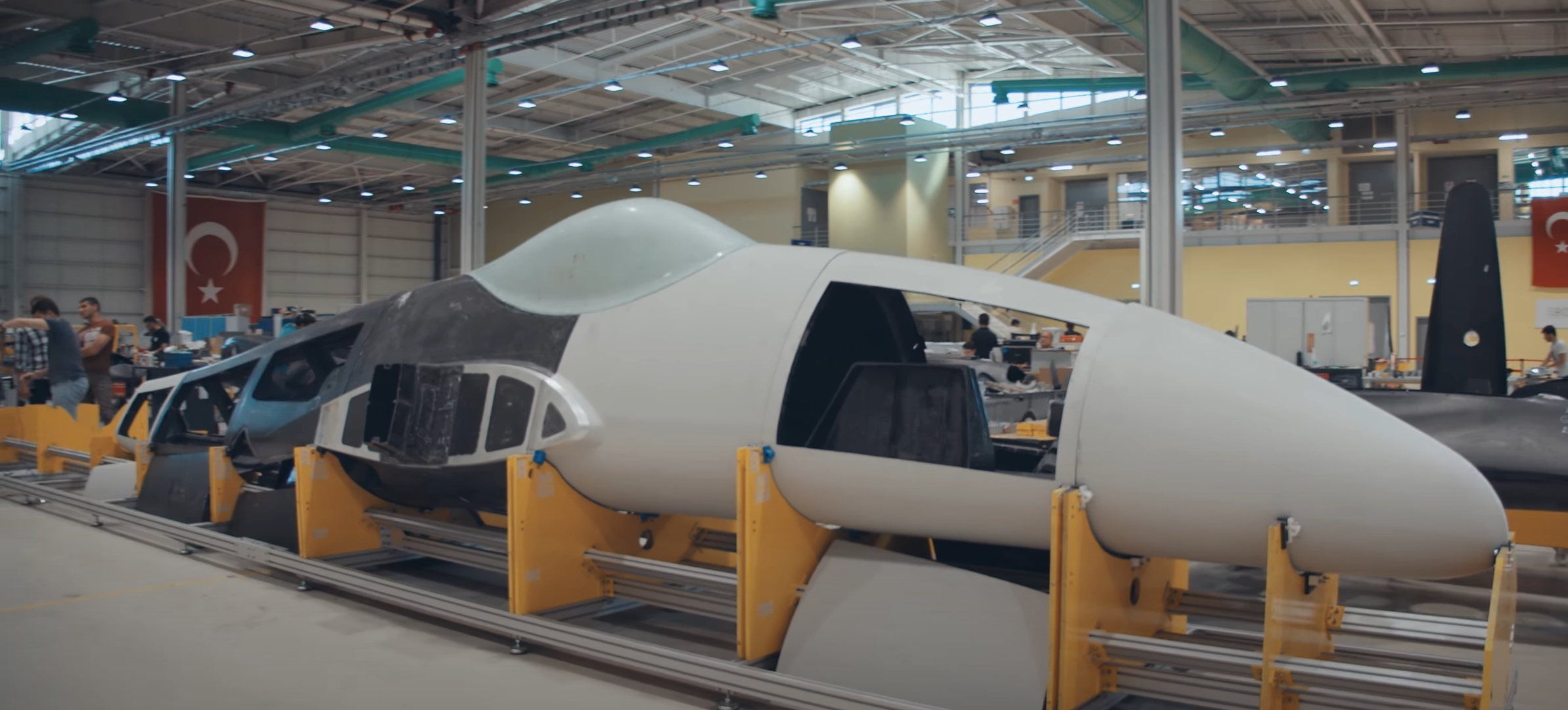

Next step for Kizilelma PT-1, just like Akinci PT-1 panels being cut out

Act like one how ?

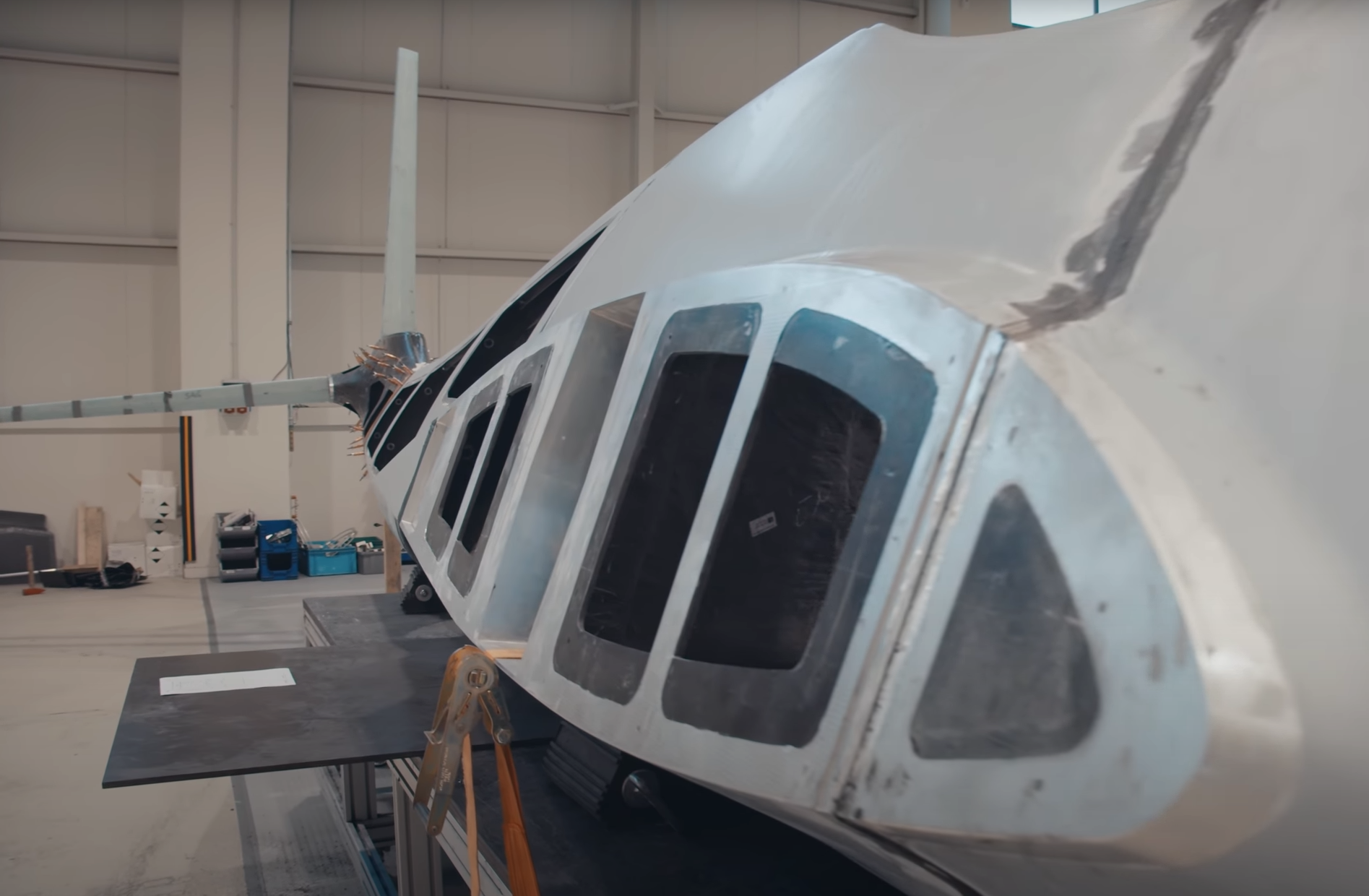

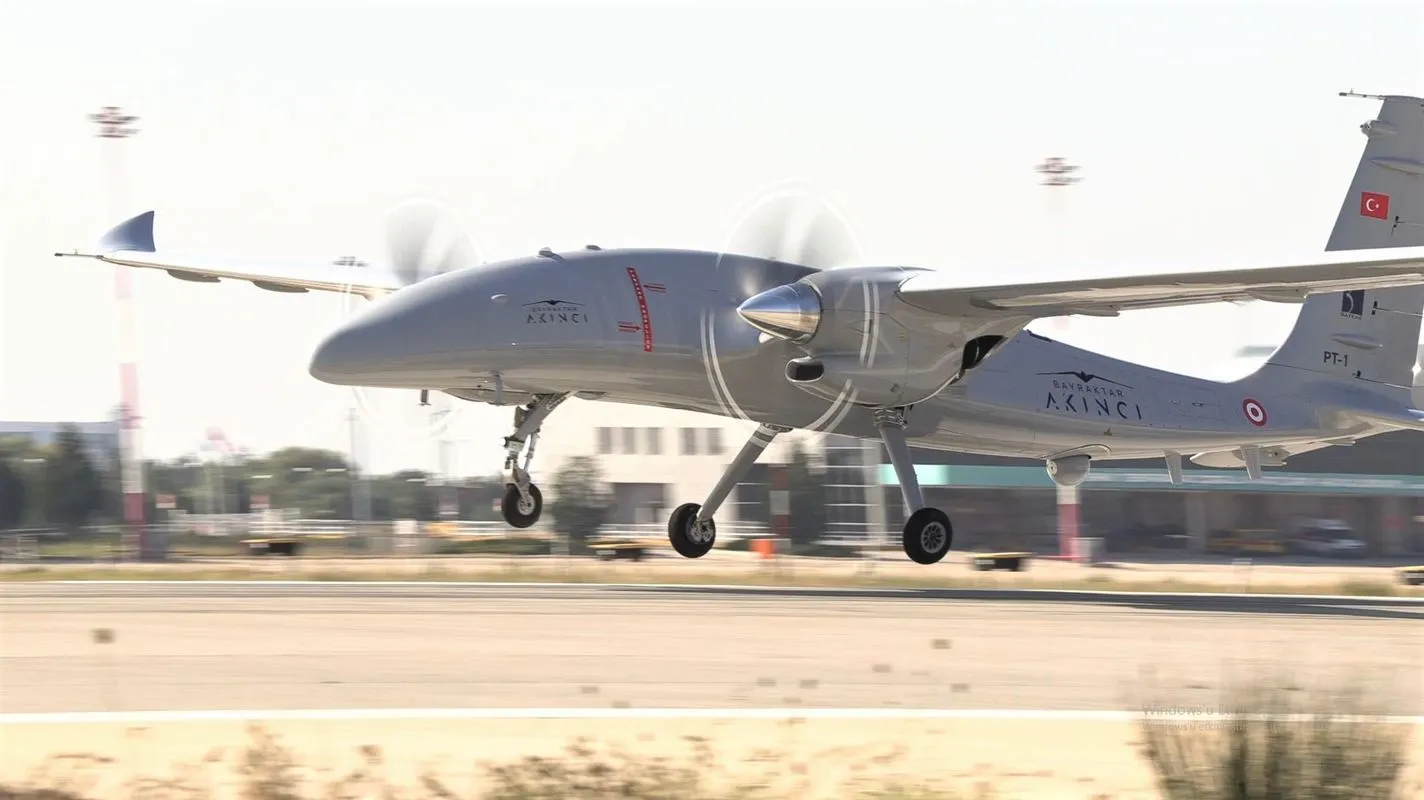

This PT-1
Became this
Selcuk Bayraktar even included Akinci PT-1 in his Kizilelma Twitter Post.
Wow. I never knew they were using this technique. It all makes more sense now. If that's the case, then yes "prototype" is the appropriate term.
The canards and the general architecture of the aircraft look fine. The wings though, look clunky and disjointed. It also looks very different from the latest renders which were released by the company. They don't line up with the fuselage properly. Maybe their CFD analysis proved otherwise but this is my observation. Which leads me to believe that the real wings may not be ready yet. Or they simply didn't bother to slap them on the prototype. Gotta wait and see.

Guys the development process is the same as the Akıncı development process. It is not a mock-up. It will probably be used for ground tests. Probably static load tests will be done on that prototype.
