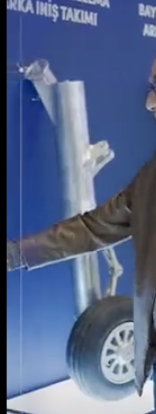

Kızılelma's main landing gear

Do we have any company(ies) that are specialized in landing gear design and manufacturing? Or the aircraft producers manufacture them within their own facilities? For instance, who produce(also designed) landing gear for Hürkuş, Hürjet, TFX, Kızılelma etc.? I read somewhere that you need large press machines to reinforce the material etc. Do we have those capabilities in house?

A good question, sadly I don't know

TAAC Aerospace Technologies Inc. was established on July 11, 2019 Joint Venture of with Turkish Aerospace Industries (TUSAŞ) and ALTINAY Defense Technologies (ALTINAY) with the aim of developing Flight Control Systems, Landing Gear Systems and Test Systems which are critical in aviation platforms. - https://taac.com.tr/en/
In addition, ALP Aviation has significant work experience in engineering or parts production for the production of landing gear for many renowned aircrafts both in civilian and military areas.
"Alp Aviation produces main and nose landing gear parts and subassemblies used in F-35 and F-22 military platforms and commercial platforms such as Boeing 737,747, 757 and 767 for Collins Aerospace and brake system components for all commercial platforms for Honeywell Aerospace. Alp Aviation is the source of the Boeing 777 main and nose landing gear parts manufactured by Heroux Devtek. Alp Aviation is also responsible for the part production, assembly and test of the Blackhawk landing gears as part of the Turkish Utility Helicopter Project." - https://www.alp.com.tr/urunler

Since the Kızılelma is a development aircraft I presume it will first be tested for long runway operation which is safer to do and be adapted for carrier operation afterwards.

TAAC is responsible for a lot of those things

+ TAAC and Italy's Managhi Aeronautica have a cooperation protocol for the design and production of MMU landing gears. From TAI's turbofan UAVs to Baykar's carrier based systems, it is impossible for almost every platform not to benefit from the know-how that will be created within the TAAC.
