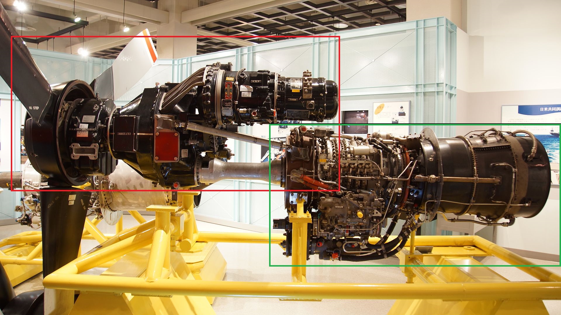

It's not a turbojet but a turboprop. One of the many things the designers at Baykar know better than you.
Turboprop =turbojet/turbofan+shaft+gear+propeller = Turbo-propeller.
Google it for basics.
Red- propeller
Green- turbojet/turbofan
JMSDF_P-2J_T64-IHI-10E_turboprop_engine_left_side_view_at_Kanoya_Naval_Air_Base_Museum_April_2...jpg
I am not implying they don't know about it, i am just hoping they won't deliver it such.
Red- propeller

You are missing a major difference between turbojet and turboshaft. Turboshaft is not meant to generate thrust therefore the exhaust gas is less energetic.
both are open cycles which directly sends freshly burnt fuel+air mixture out.
Both works in a similar way while one focuses increasing output-exhaust momentum, the other focuses on conversion of this momentum into rotational one.
If you carefully look other cases which turboprop, turboshafts are applied you will see enough exhaust length, metallic parts covered with insulators and IR suppressors installed at exhaust outlets.
the problem here is not about type of the engine but exhaust is still at the same temperature as a turbojet for being a jet-outlet, and exhaust, which constantly will be warmed up to the exhaust temperature, and is naked.
