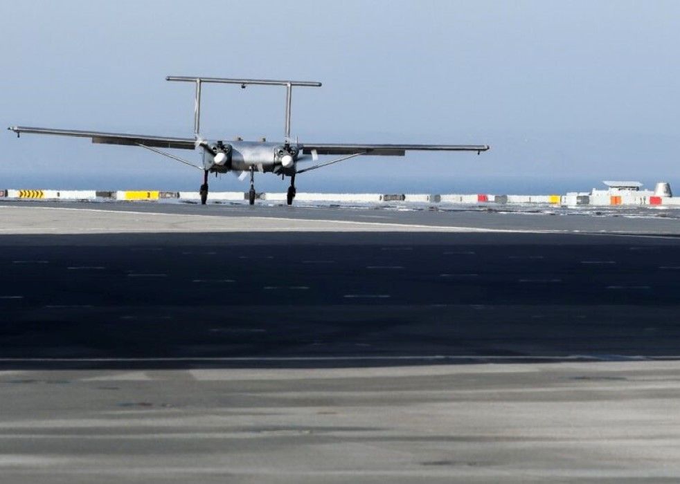

I really Wonder how high this drone can operate with something like 4 mam l bombs. If it reaches around 30 to 35kft, then it is very well done with the Tei engine.
Probably current pd170 is in use due to ongoing developments in pd222 which has much higher take of power which would allow tb3 to take off from tcg Anadolu with some payload perhaps.

We have no clue how much power the TB3 needs to take off from the Anadolu but if it lacks power some cable tug assist will work wonders. A more powerful engine if the TB3 ever needs one will rid the assist cables but is not absolutely necessary.

The TB3 is expected to join the Navy ranks in a month but is it like the TB3 will be deployed earlier then expected, I don't think so. It still needs to learn to land on Anadolu nicely before it can be fully operational on the ship. But the earlier the delivery the earlier the Navy will familiarize itself with the plane and be prepared for deployment. I think the TB3 can be used for ISR duties initially and after that it can be launched from the ship but would land on land based airstrips. In this way when you can deploy 10 TB3 on the ship you get a chance of 10 sorties to targets with full payload during an expedition. This will give the navy a taste of what TB3 will bring before it is fully deployed on the ship.

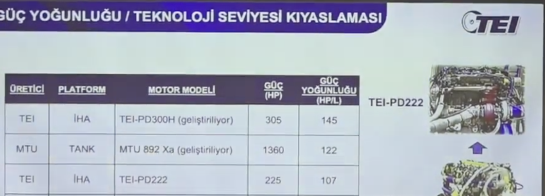

what about the PD300 ? what platform is it for ?

PD300 is a little on the weak side for Akıncı and on the strong side for Aksungur. There seems to be no existing platform that this new engine is made to perfectly match. It is more of a project to take the PD170 to the extremes I guess. There is not really any information about it. However a new platform should be made to make use of this engine's full capability. If it is light enough which seems to be so it can even be used for VTOL aircarft. Like helicopters and compound helicopters that have both helicopter and plane features. Also civilian sector should catch up to use such engines. Some companies had seaplane development work in the past.
EDIT: I have just noticed that the PD300's full name is TEI-PD300H, with the H designation in the end a helicopter platform seems to be what is in mind. A 1500kg MTOW helicopter can fly with one of these engines which means 6 seats including one for a pilot. Wonderful !
EDIT: This also means that this engine is tuned for low altitude like 20k ft max rather than a high 30k ft.

What we know for sure is TB3 has flown in 130 kmh winds taking off from land. Off course landing back on the ship will be challenging, still some machine learning and AI will probably assist in such a feat. I have seen videos of smll drones flying in stormy weather, but it will take a lot of tuning to get there. With 1450kg take of weight TB3 has quite a bit of heft to stand some wind, I would say.

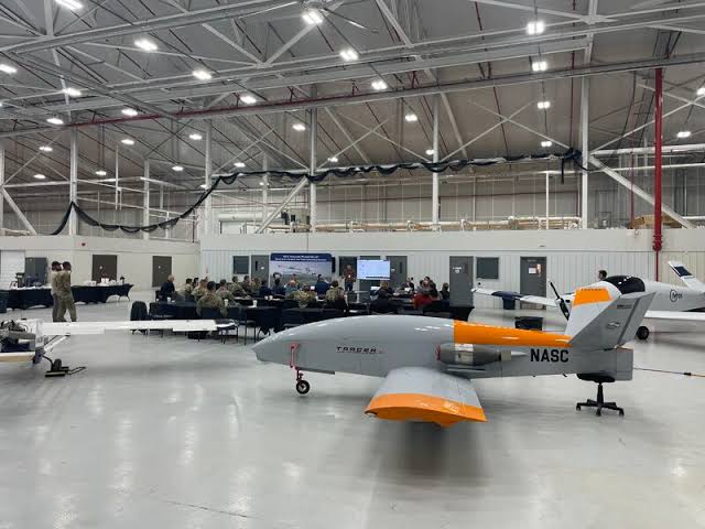

TEI can produce compact jet engines.
Would not be better and safer such jet powered Naval UAV?
I don't think it is expensive.
Small turbine engines are good for fast planes or missiles, for cargo or weapons load carrying propellers are more efficient. A small, rather high bypass turbofan engine could be used to strike a good balance between speed and efficiency but there is next to no such turbofan in production. Turbine engines are rather inefficient when they are small.

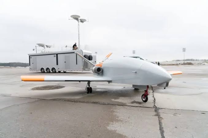

I meant for naval use. For launch from AC. Let's solve the problem which doesn't exist:)
Along with the propeller one or two microturbunes could increase take off speed. Kinda additional JATO (Jet assisted take off) When stalling UAV uses just propeller.
There maybe use cases where efficiency comes last like when boostering a plane in take off but still there are other solutions to the problem like catapulting or tuging with cable which are more convenient.
