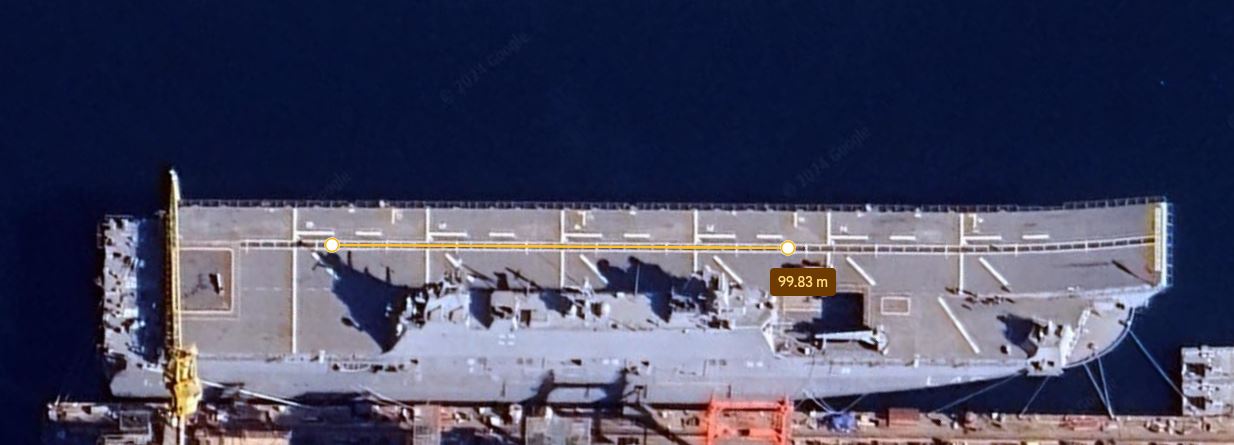

Unless I miscalculated, TB-3 completed its first landing test just below 100 meters.

Great study. By the way, how many lifts are there in the ship? As far I see, one is at the back. Any other?
There is second aircraft lift on the starboard side, which capable of lifting and lowering the F-35B.
