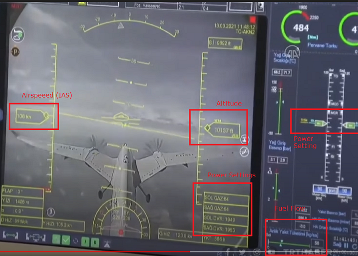

Power setting and fuel flow visible from the footage. At 10000 ft it uses around 100 kg/hour of fuel with gear down in slight turn, the endurance will be around 16 hours at this level with the same settings if the fuel tanks were full.
At higher altitudes the throttle (engine load) will have to increase, engine efficiency increases, maximum power available from the engine decreases, for same settings fuel flow decreases. If the landing gear is retracted fuel usage will be lower, all of these pushing endurance higher.
Higher quality, in case more information can be gleaned from it:
