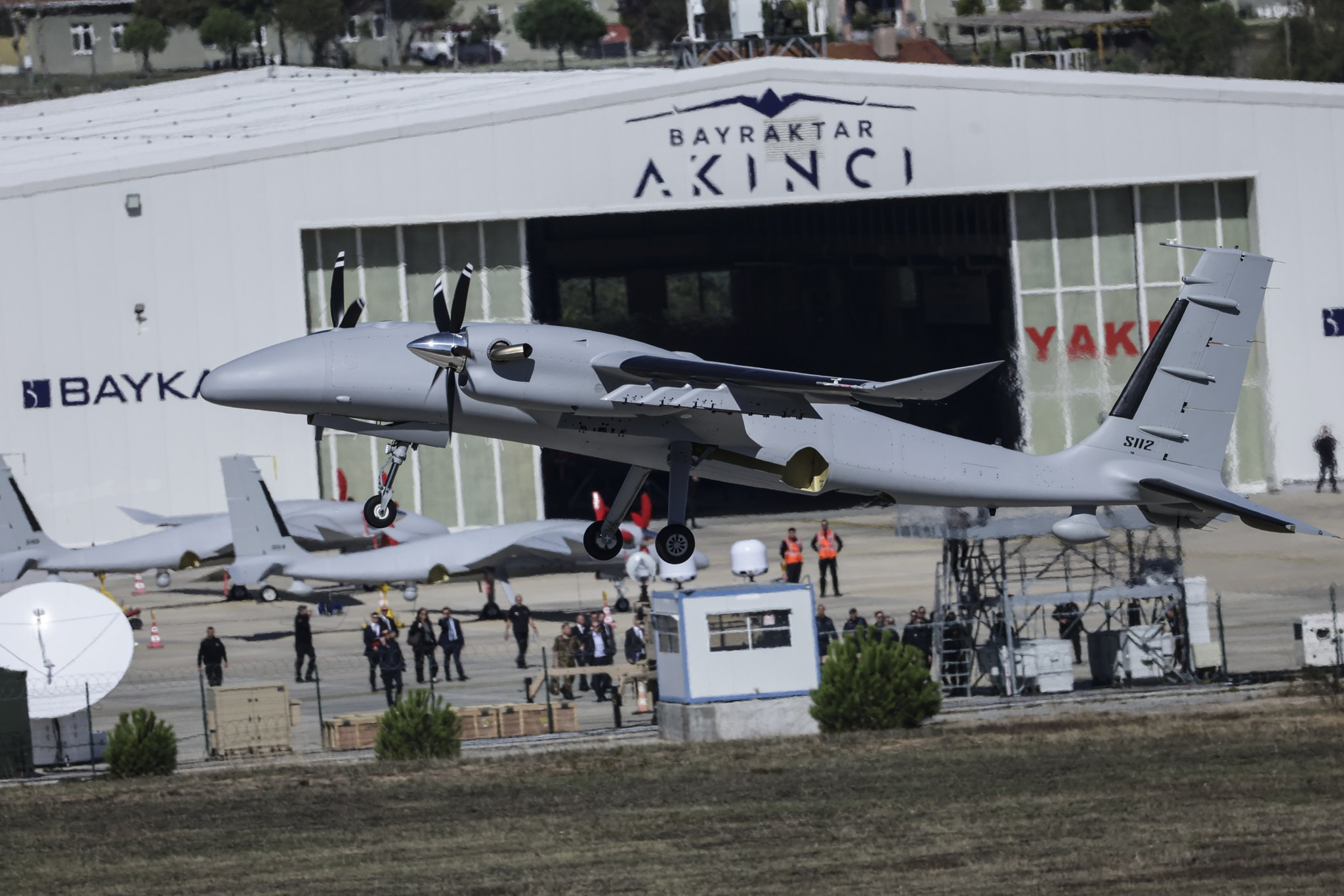

I think some of you guys are comparing Kizilelma with akinci and that is not right.
Kizilelma is not going to be remotely controlled al the time it's will get its mission and operation guidelines and will operate mostly autonomous its closer to the F16Vista than Akinci or tb2. That doesn't differ so much from pilots as they rely mostly on the avionics/mission settings anyway the only thing it will miss the ability to look beyond.

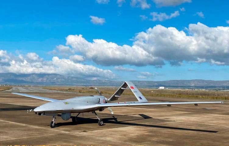

It is an average Round Trip Time latency in satellite communications and not specific to Kızılelma. 100ms RTT is for landlines I believe. I am not sure if the Uluğbey satellite constellation at 510 km altitude will have a better latency, and perhaps it will if the 2 second delay is on the 36000 km geostationery orbit satellites.
I checked the Starlink latency numbers and they are at around 50 ms. If Uluğbey is at 50 ms delay then Kızılelma's prize will have to go up quite a bit. By the way you can't take state of the art latency numbers for granted as they will not sell it to anyone to use in the military.
It is actually based on communication system they used as you said.
Bayraktar TB2: LOS link ~20–50 ms, satcom mod ~600+ ms
Starlink based UAVs: 20–60 ms
Iridium Certus: 30–100 ms
If Uluğ Bey will be used in communication as well, it will be great.
