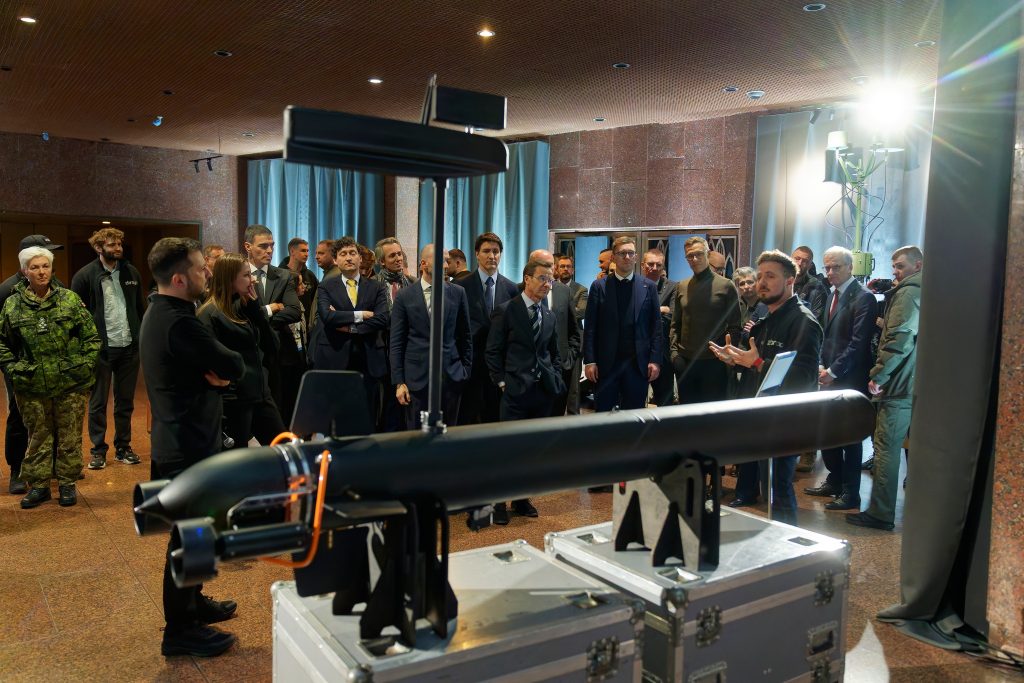

Semi submersible or just below waterline USVs (like the drug smugglers use) would be more efficient. With electric engines and correct propellers they can be built to be very quiet and fast.
Ukraine already has one in the pipeline called toloka and being updated in to a family of drones.
France, UK, Russia and many more are working on the idea of uncrewed submersible sea vehicles.
