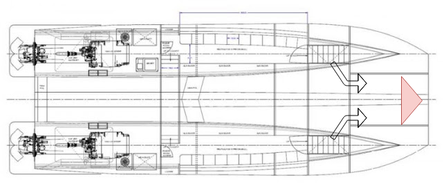

What do you think about design improvement that can be done from the current design?
I am thinking rather than using both hulls to carry troops then climbing to the front and disembark from a ramp, maybe make the front of both hull like the rear of APC.
Less disembark time and less exposed, but more materials at the bow and more troops close to the bow, the buoyancy will be insufficient thus need bulbous bow, wider and bit flat so the boat can get close to the shores and the boat can still a bit flying/move close to the surface when moving fast (not sure if its technically possible i am not an expert about hull and bow).

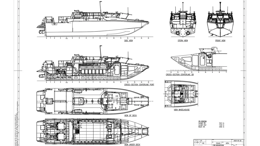

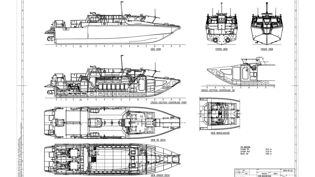

You mean something like CB90, KMC Komando, Taiwanese MPAC i think.
They can make exits on each hull either towards inner or outer side. Inner side sounds more secure to me, and they can lower portion of the front deck as a ramp to further allow the teams disembark.
Something like this:
I think they will update the design as it is used by Army and feedback is given.
That's even better suggestion than mine.
It was a quick one,
I am sure there will be some other troubles for opening a hatch on the side, making it watertight and keeping hull integrity. But i am sure they can solve those matters if it comes down to that.

It was a quick one,
Just exit from the front.

If the shipbuilder and the user want a more efficient and safety design for troops disembark, they should modivied the front section, and perhaps try to modified it more less like CB 90/KMC dismbarkation ram-door,
Make the lower section as a ramp, and upper section has clampshell like hatch. I thinki its doesnt much affect the survivability of the boat since the middle part isn't directly have contact with the body of water.
