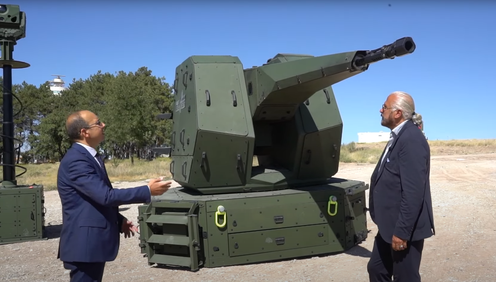

Iirc Gökdeniz-ER is supposed to use Bozdoğan or Gökdoğan
Gokdeniz-ER : shown below is work of Aselsan and Tubitak Sage
No clear information on the missiles to be used. But as you mentioned is thought to be a derivative of Bozdogan.
Basically thought as a stand alone unit with its own Aesa based radar system.
Levent Missile system: is developed by Roketsan.
It would be interesting to know what missile they used to develop this new “evolved” Sungur. It certainly looks much beefier than standard Sungur missile.

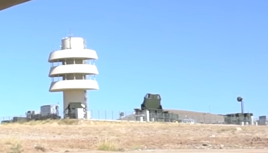

I wonder where is siper's fire control radar! And How long it will remain hidden! Clearly the search radar ERIS already has been shown publicaly.
Who knows?
Maybe they want to use EIRS with some and some with FCR+EIRS
