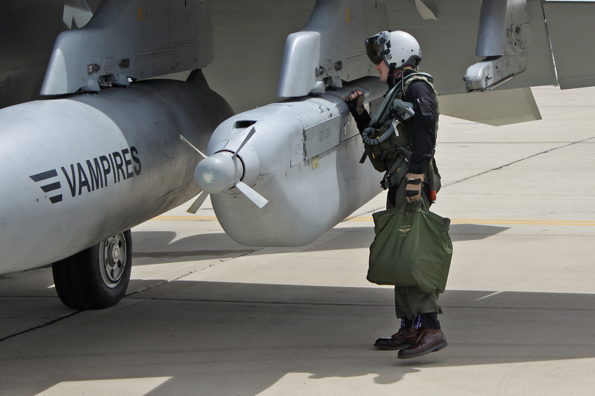

If a platform like Hürjet doesn't have enough energy generation within the engine for that radar, is it possible to add additional generators for radar like in a pod?
Possible, but probably won't be necessary. US Navy's ALQ-99 jamming pods do have ram-air turbines to power the equipment.
FocUxeFXwAIFgoy
If we manage to keep the APU running mid-flight and channel its power to the AESA array that would do wonders.
