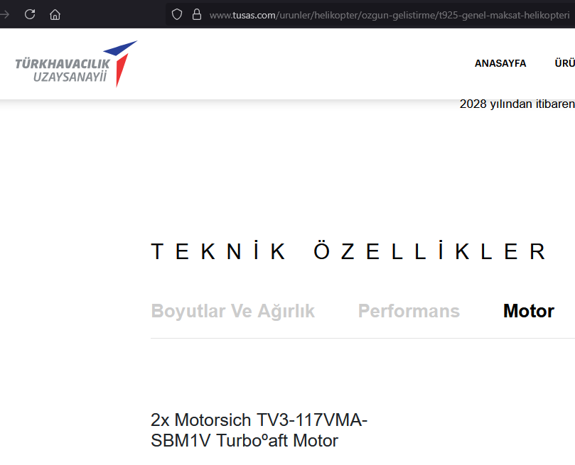

In long term, Gökbey not only isn't ready but it isn't even enough and T925 exist only on paper yet, we can't wait for them. We should've made a deal for AgustWestland's Merlin and AW149 ages ago and started production already at least we could've had 8 and 15 tonne helicopters (for TF2000) in production already.
Good point. But anything bought from anbroad other than Seahawk means more hassle than it is worth. We are used to maintaining Seahawks. A new foreign aircraft will mean new maintenance facilities and teams; or depending on manufacturer based maintenance. It may be cheaper for the short term to purchase a handful of Seahawks than buying Merlins whose engines are French/Safran built. Hopefully local T925 will come in before we need new heliciopters.
That's true but if we can't or won't get Seahawks just waiting for T925 to not just be built but get navalized as well as waiting for Gökbey to be navalized as well while being short on helicopters is insane. We are short right now, and we are building more ships already; we are going to end up pulling more helicopters from the army and putting them in conditions they are not made for on the ships.
There is a difference between ideal world and reality we live in and we fucked ourselves in the real world while chasing an ideal.

T925, however, went through so many design changes that, I’d rather call it change of heart at this point. I don’t know, I can’t help but get the impression that decision makers gave up on a hunk of a naval heli, a workhorse and rather confined the design into a medium - heavy army utility helicopter. The last design change was to reduce it to a 10-12 ton and was supposed to fly in 2025.
