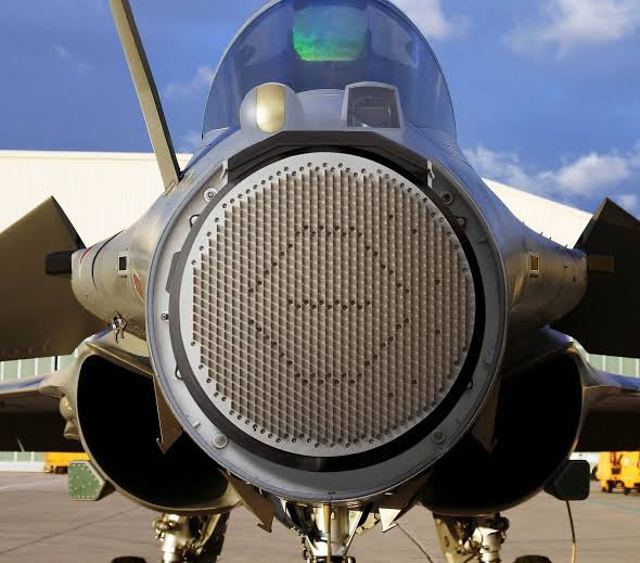

I don't think a bigger AESA can be fit in that nose? RBE2 has 838 GaAs T/R modules. The best that can be done is probably to switch to a similarly sized GaN AESA. BTW neither RBE2 nor APG-83 SABR have necessary capabilities to fully take advantage of Meteor missile.
main-qimg-32c77cba4cabe33d8560e979fc5b31ca-lq
GaN modules should give the capability to take the full advantage of meteor.
by tilting the radar at an angle, theoretically they could increase the no. of TR modules
the question of whether the Rafale's engines would be able to generate power for a more power consuming radar is there.
