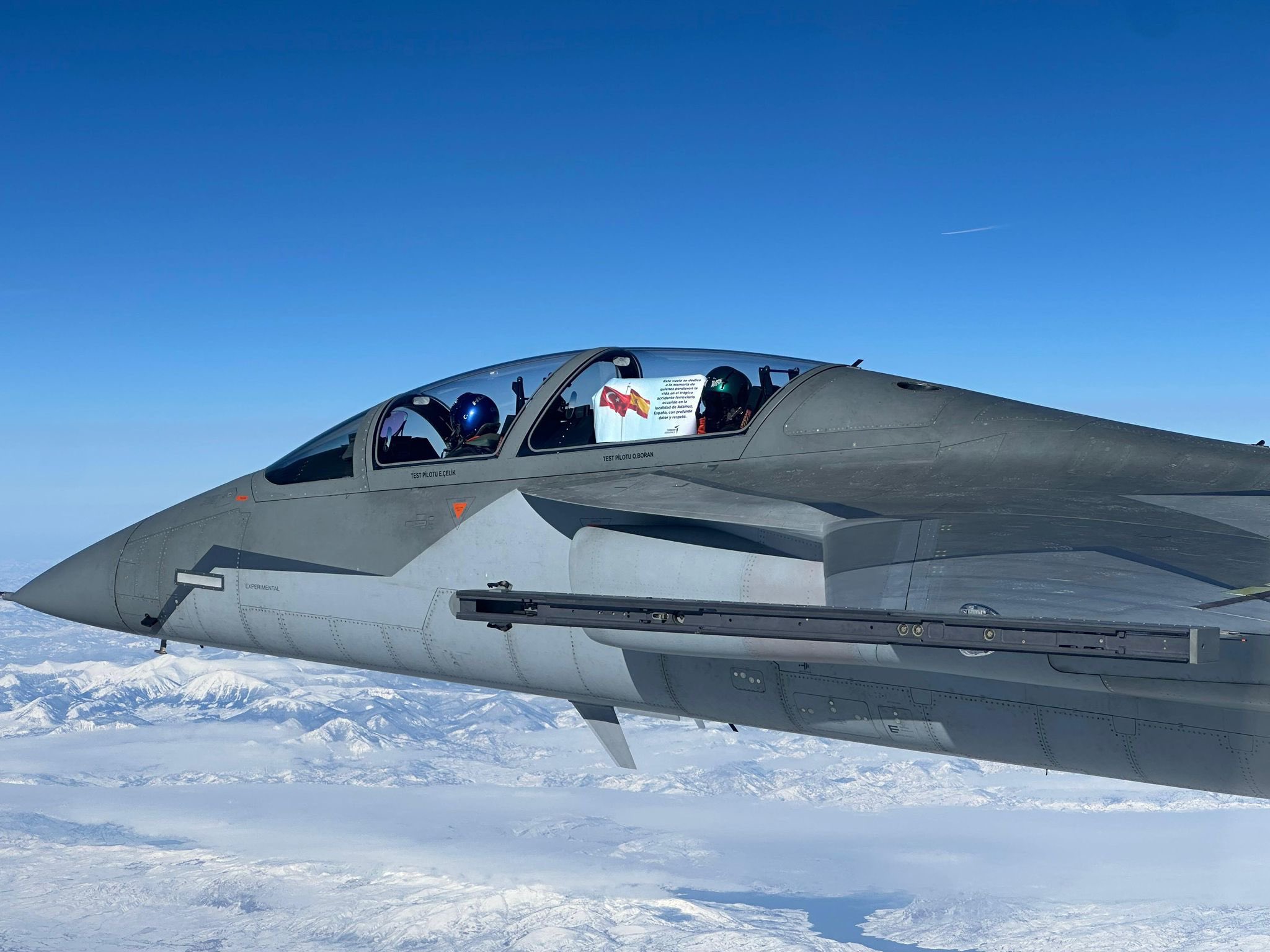

It’s official now.
The signing ceremony was held at at Airbus facilities in Madrid, Spain.
SSB President Haluk Görgün:
"We have held the signing ceremony of the contract regarding the export of the Hürjet advanced jet trainer aircraft, developed with our domestic and national capabilities.
This agreement represents an extremely important milestone in Turkey's history, as it marks the first time Turkey exports a manned, jet-engine powered aircraft.
Our Hürjets, produced through the joint efforts of dozens of our companies under the main contracting of TUSAŞ, will be configured by Airbus Spain and TUSAŞ in line with the needs of the Spanish Air and Space Force, and will represent the strength of Turkish engineering in European skies.
This project is a reflection in the defense industry of the Turkish-Spanish friendship strengthened under the NATO umbrella.
Under the leadership of our President, Mr. Recep Tayyip Erdoğan, Turkey has become a solution partner for many friendly and allied countries, including NATO and European nations, as a result of its national defense industry mobilization; in a period where international defense expenditures are increasing and supply security is being tested.
I would like to express my gratitude to our TUSAŞ in particular, as well as to the efforts that made this agreement possible; to the Spanish Deputy Minister of Defense, Ms. Maria Amparo Valcarce; to the Spanish National Armaments Director, Lieutenant General Miguel Ivorra Ruiz; to the Spanish Ministry of Defense Director General of Armaments and Materiel, Vice Admiral Aniceto Rosique Nieto; to the Ambassador of the Republic of Turkey to the Kingdom of Spain, Nüket Küçükel Ezberci; and to the Ambassador of the Kingdom of Spain to the Republic of Turkey, Ms. Cristina Latorre Sancho."
