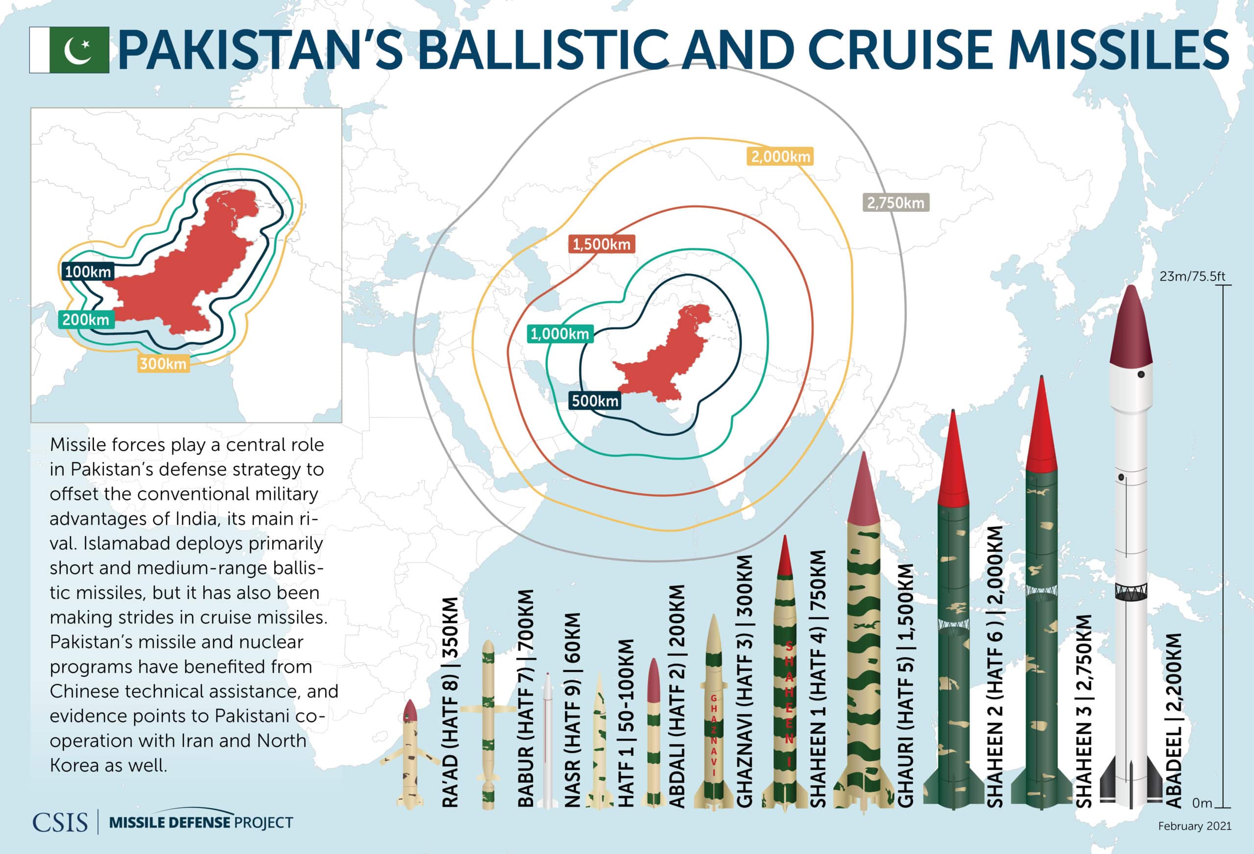

@Bogeyman
Regarding the stockpile of Turkish missiles, I refuse to believe that we don't have Pakistani missiles and rockets in our arsenal. It simply doesn't make any sense if you consider the deep-rooted, secretive and strategic nature of the relationship between the two states.
My guess is that we have a very high amount of unrevealed Pakistani origin missiles in our inventory.
Why would we have Pakistani origin missiles,for what reason?
Why? The question should rather be why not?
