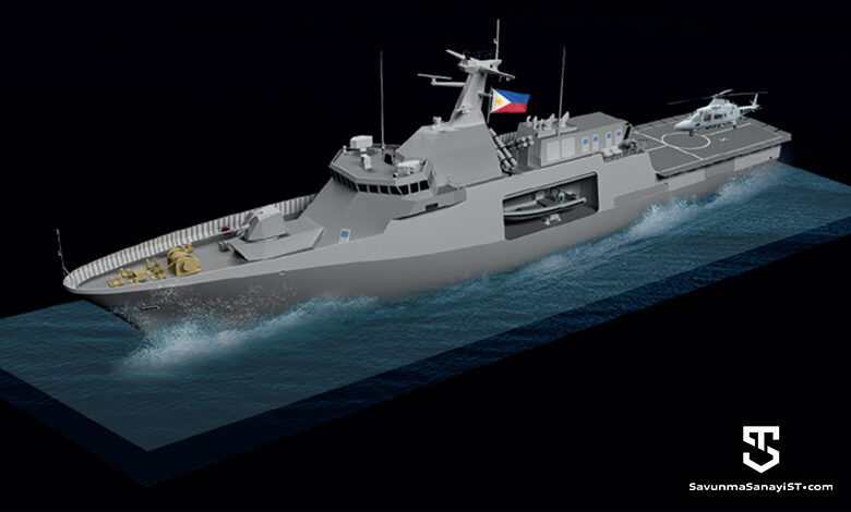

Have the weapon systems been specified in the hisar class OPV? As far as I understood the design is based on the ada class, with almost the same displacement at 2400 tons?
2,877
125 14,545
1664981830479-jpeg.884923
Combatant configuration options:
76mm Main Gun
1x ASELSAN GÖKDENİZ CIWS
8 cell HİSAR air defense missiles
8x Anti-Ship Cruise Missile
4x ready to fire ROKETSAN L/UMTAS missile system
2x ROKETSAN ASW Rocket Launch System
2x ASELSAN STAMP remote controlled weapon stations
TACAN, adequate hangar for unmanned or ASW-ASuW helis
YAKAMOS Hull Mounted Sonar System
HIZIR LFAS Low Frequency Variable Depth Active and Passive Towed Array Sonar
Torpedo Countermeasure Systems
ASELSAN MAR-D Search Radar
Electro-Optical Sensors
ECM systems etc.

Nice, it's indeed very similar to Ada class, both are considered corvettes. What's the difference between this two? Electronics? Is the price of the opv specified in the information that has been published, I remember that a year ago someone mentioned that the price of the opv would decrease by around 40 % compared to the ada class after all the turkish weapons, and subsystems get matured.
2,877
125 14,545
As you know, almost all of the major cost items in combat ships are the navionic and weapon systems, so combatant equipments. Hull construction and sail equipment have a more limited share in the total cost. Also, If you look at the ship's propulsion system, you'll see that the engine room consists of diesel engines.
The doctrine behind the HISAR class OPVs is to have a design concept that is suitable for considerably economic operations in peacetime(as an offshore patrol vessels), but allows configuration changes without extensive re-construction activities in case of any crisis. A similar approach can be seen in the newly built OPV frigates of the Italian navy.
4,315
276 22,569
Just to add to @dBSPL ’s post;
According to unverified estimations, Ada class corvette costs around 260million US dollars.
Basic OPV based on same hull will cost in the vicinity of 110 million dollars. But this cost quickly escalates as you start adding those weapons. (A RAM System alone is best part of 25 million dollars)
As mentioned, OPV is a slower vessel as it doesn’t have a gas turbine to propel it. I’s electronics and radar is cheaper. It is for off shore patrolling missions. But not for open seas.
Beauty of it is that, as Ada Class has been built in a modular format, it is more tolerant to quick additions of weapons and electronics as and when needed. They can even carry ULAQ USVs. This will give them stand off weapons usage range.

Nice! How much will the OPV cost when you add the same weapon systems as @dBSPL mentioned in the Hisar format? The flexibility in quick changes in electronics/ Weapons without extensive work is a big plus :)
It is based on Ada-Class, that is why. In near future it may reach 90% or even 100% cost of Ada class with all equipments installed (full version) but once Ada class receives the MLU the ratio will go down to 60 - 70%
Ada class will receive EA/ED, Second generation ESM, Cenk-S, IRST, and AD missiles in MLU.
The further note is written based on MLU expectations od Ada class.
While OPV will incorporate Mar-D in place of Cenk-S, Low tier ESM in place of ARES series, Compact EA in place of full EA / ED system. While rest of ammunition is close except the Gokdeniz - and Turkish PDMS.
