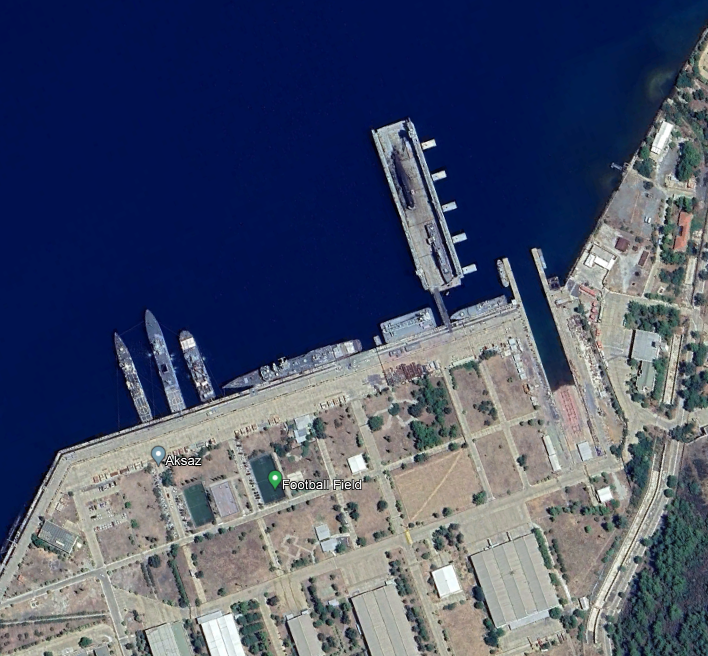

More shipyards is great and all, but is Aksaz the best place for such an installation for our most strategic vessels, being that close to Crete.
Also defines that Anadolu and other strategic assets have nothing much to do within Aegean, Marmara & Black Sea region, thus they do not need to be in Istanbul. They are destined for overseas.
I am 100% sure some people will be complaining of private shipyards not being utilized for maintenance of large platforms, so in advance i am telling that private shipyard's motive is purely commercial, thus they may shut down, dismantle, sell, demolish large dry docks if they stop turning money in. This is logical move to ensure maintainability of strategic assets.
I like how TN plans these details ahead. This would apply to any country around the world; if you are only hearing numbers and seeing images but seeing little mention or improvement or motives toward securing the maintainability of aforementioned numbers, you are likely to be told some lies and live in a dream.
