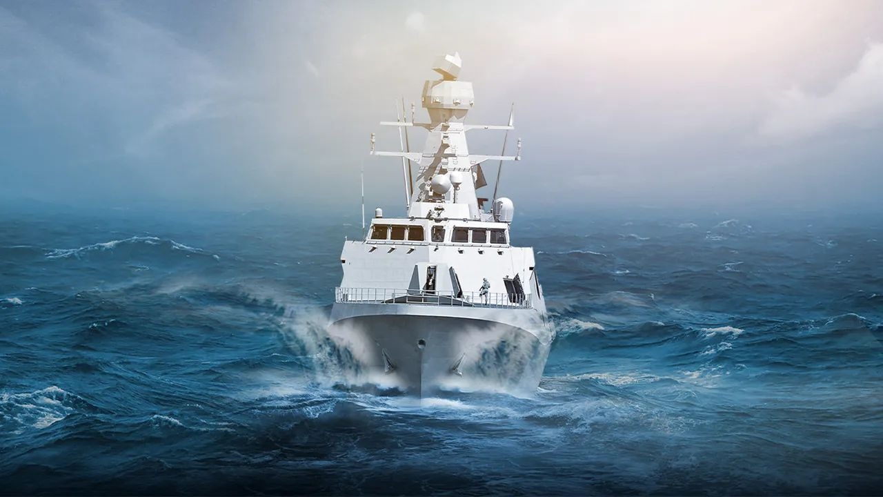

New brochures for TF-2000, I Class, OPV and PN Milgem from ASFAT.
Thanks to Catfishblues.
