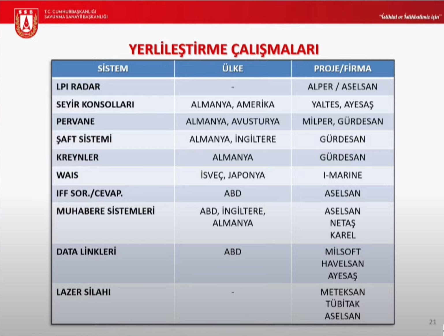

Is this okay to share this with public? You can clearly see the propellers. The Official Ministry account deleted the tweet later but I hope the Turkish Defense Ministry knows that the Twitter is a huge blackhole. Serious OPSEC failure for Turkish Navy, damn.
By the way, does anyone know who's running the official account?
Some people in SSB is really stupid though they have published the video right away without appointing Navy personnel, not the propeller but the hub should have been covered or not shown by video.

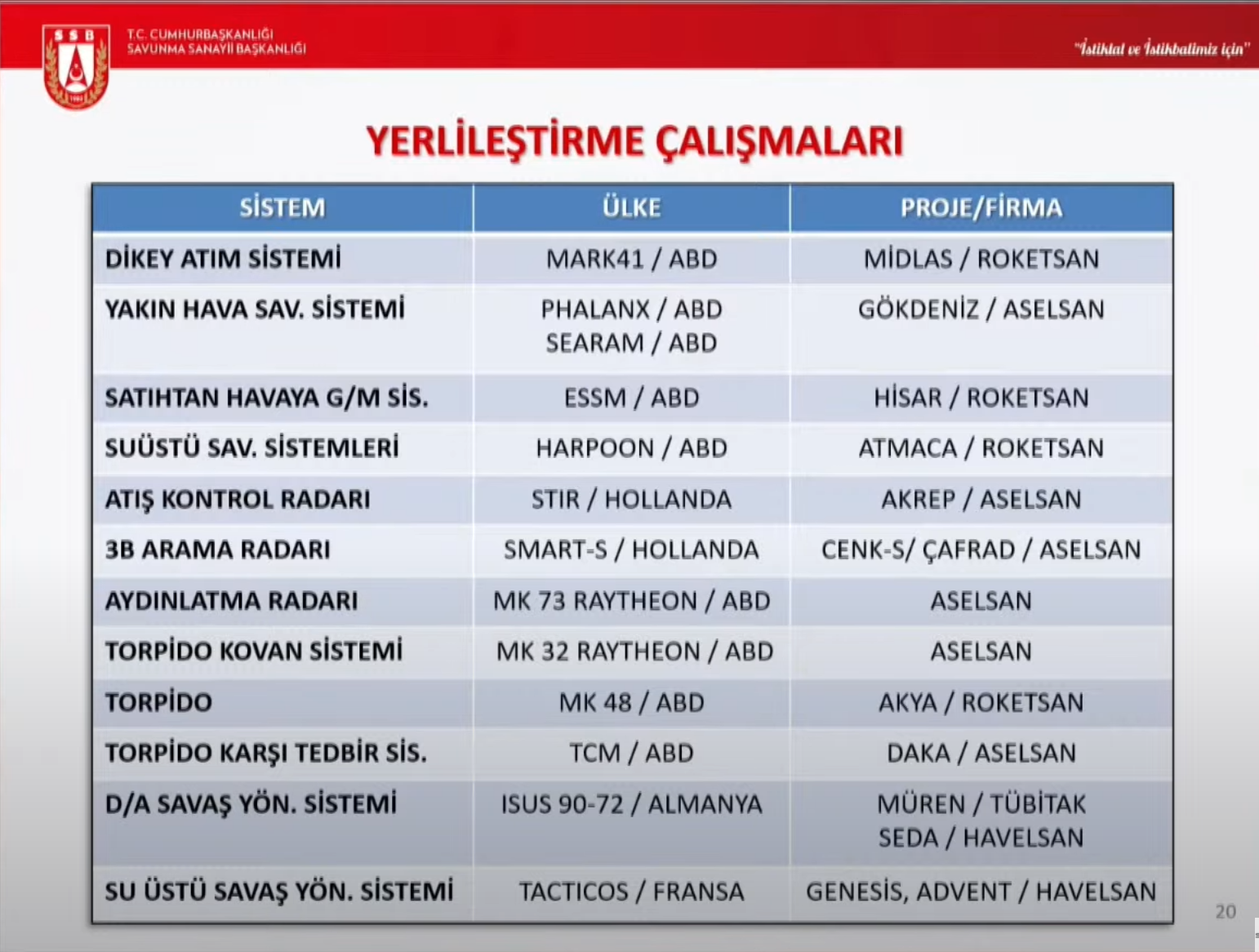

Updates:
-Turkish Navy doesn't have SeaRAM but RAM, Sapan will replace it.
-Hisar doesn't replace ESSM but G-40 does.
-Milper has gone boom, i don't think it has any personnel anymore. So some parts related to shaft,stern tube and propellers have failed currently.

What is the secrecy about the propeller?
The shape used to be secret, not anymore, the tip point and number of blades tell a lot to people who works in acoustics field. Nobody keeps hiding it unless it has a fairing-duct (ie. a water-jet type propulsion), the distance between duct and hull, number of blades of the impeller is more secret nowadays.
