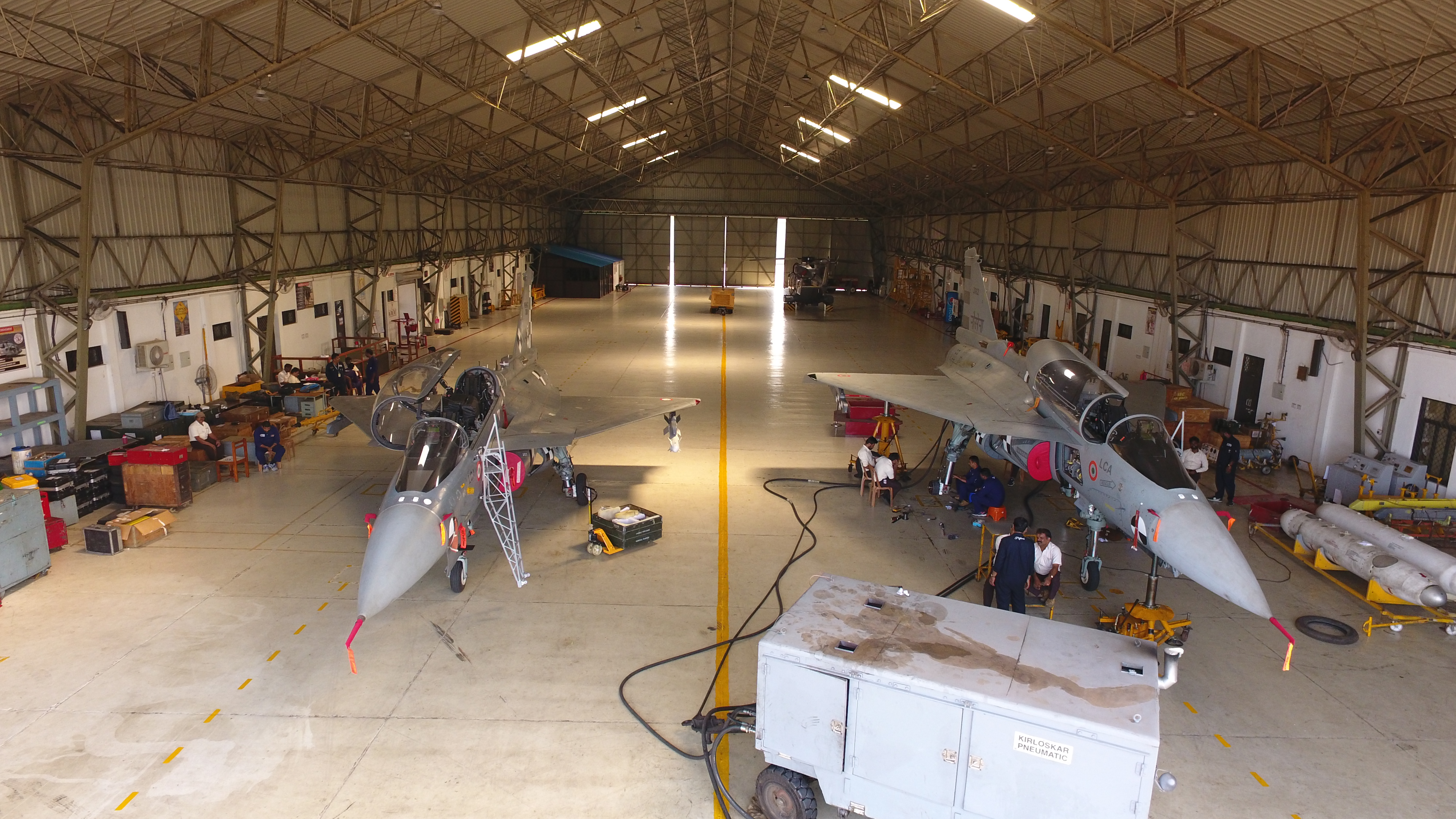

TEJAS Airforce configuration (left) - TEJAS Naval Configuration (Right)

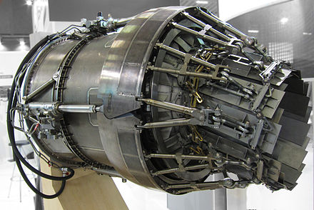

a VTOL aircraft requires a special engine that acts both as a jet engine and a turboshaft engine. At least this is what F35B is like. However if you want to make things simple you can use two separate engines, one for jet thrust out the back and the other to drive the lift fan like propfan (high solidity turboprop). Given the existing products of TEI the TS1400 and the elusive TJ1600 combo can form the Voltran. A little farfetched but possible.

It would need a MAJOR redesign to survive landings even. Landing gear is too weak, and carrying capacity will likely be reduced as well.
I wouldn't go as far as the express major in all-caps, but yes it would have to be modified - that's a given, hence feasibility studies being conducted.
Basically, it will have the same weaknesses that made India refuse to use the Tejas on its carriers.
I don't think that applies here, the reasons why Tejas didn't go as planned is multi-faceted with issues arising from all areas of the project - naval variant probably had the least issues. Also, one of the major gripes with Naval Tejas seemed to stem from it's weight - Airforce variant Hurjet is likely going to weight 4.5tons empty where Tejas weights 6.5tons empty - Naval variants add extra 400kg for strengthened airframe and landing gear. Hurjet would still weigh much less.
